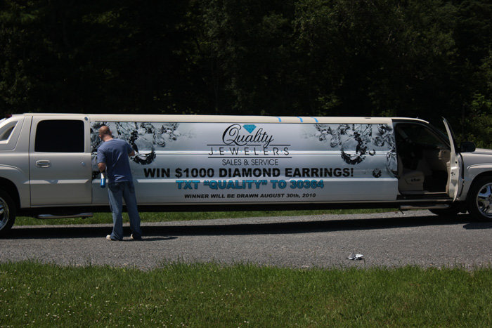

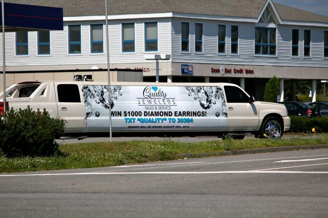

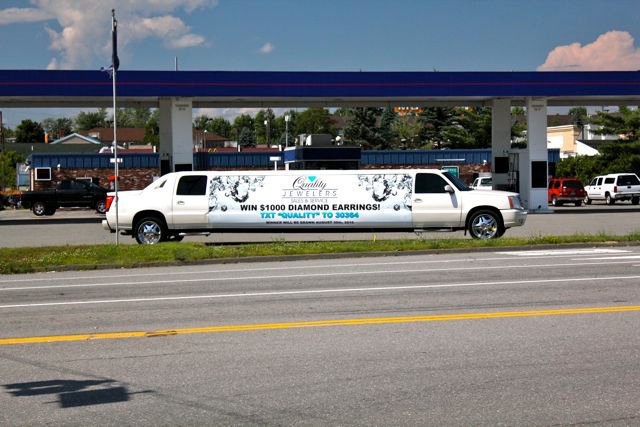

ericmitchell29
I did a job that was going on for one week and then back off. Designed/Printed with the 180 without egress. ... Laminated.
I thought, no big deal, its a rolling billboard for one week.
Learned my lesson. .... by the way I laid it down by myself with no seams.. one giant sheet so I could have been my own worst enemy but I would definitely not go the cheap route again, It was just a bunch of time getting my bald head burned in the sun when I could have been off onto another job.
Here are some pictures of the finished job.
P.S.... The job was going to go 1 of 3 vehicles so the color match never happened. Would have loved to had it blend in better but... customer was just looking to get some extra cash for his limo's during the week when it wasn't busy.

ericmitchell29
Yeah, you definitely can, I can't speak for how long it will stay down though as mine was just a short term job.
Plus... there were a few issues up close on this one, mainly that I couldn't get some of the air pockets out... nothing big, but if it was long term, it would have been an issue.
