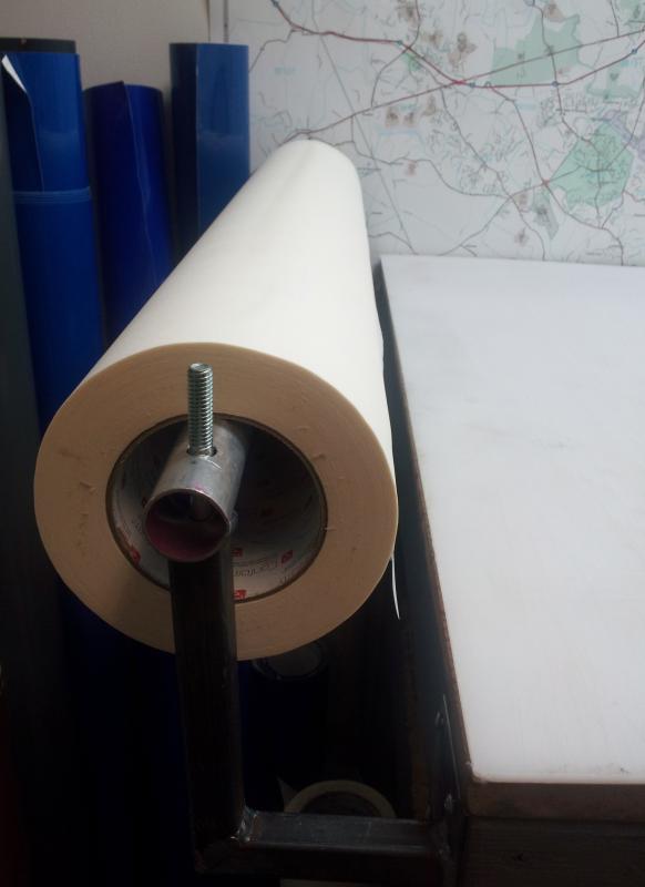

Here what i have made up and use, works well and simple design. Made from 1inch box tubing and flat plate for mounting it to the table. Bolts and washers at the top to hold the cross bar
Z SIGNS
Nice tape holding rig highspeed. We have one similar.I think it's the best way to lay down application tape.Why would anyone do it another way ? Unless you have miles of transfer tape to do every day I think a contraption like a sheeter is a waste of time any money.It's bought by people who don't know any better
