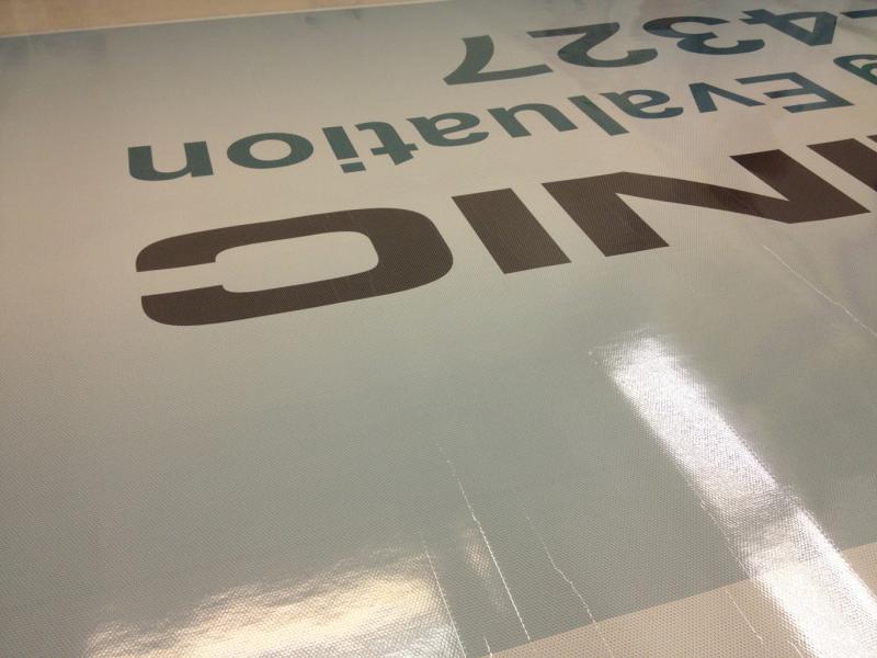

Hello,
I just laminated some solvent 50/50 window perf with clearfocus ClearLam perf 54" on a cold laminating.
As i was laminating i was rolling it up (print side in) only minutes later after laminating there are lines of wrinkles in the lamination. Is this common? Will this go away over time? Please advise.
I am attaching pictures.
It was printed on jv33 the ink dried 24 hours.
Thanks!

I would almost think the lam is defective. I cant say for sure that it will go away. They look like very thin creases so they may be permanent
Wiggum PI
yeah, perf in general doesn't play nice being rolled face in, and the fact that you done it straight off the laminator would be your issue im guessing.
sfr table hockey
I too think that rolling it image side in was the issue.
I think any media laminated would do similar if not worse when rolled image in.
You could try to heat the creases and see if they let loose so you can press them flat. It's worth a try as they are no good this way.
Most times the crease will not let loose or the adheasive will release instead off one side and then you will not have anything to keep that spot from lifting.
Just remember any cut vinyl on banners etc. or anything laminated should be rolled image out.

This is tunneling. Rolling it face out will help, but you may get tunneling between the back liner and the print. If you do not as big a deal.

face in did it, perf has a lower surface area to start so rolling face in is more likely than other adhesives to pull the lam off.
I roll all my laminated stuff facing out no matter how long it has to sit.

always, always, always roll laminated prints image side out. Had it happen once when I laminated a big sign order in a rush... everything tunneled & had to be re-rushed. :(

Nope. Rolling laminated cast vinyl won't do that if you roll it face in. But due to only 50% of the laminate stuck to the perf...the other half wants to buckle.
It's because it's perf for sure.

I had the same problem with that lam and didn't roll the print at all left it flat. Different perf brand but same lam. I had a lot of trouble just getting the lam to go on smooth. In my environment I shouldn't even bother with sheet lam just spray lam but my boss likes the glossy effect the lam creates.

I relaminated again rolling the print face side out and the issues where not anywhere near as bad, but they where still happening.
From all of my research so far i am thinking it is the clearlam, I am going to try a different brand of laminate. Any recommendations on what laminate? i read some people are using 3m 8518 does that work? My plan is to buy oracal 290F, has anyone used this?

the laminate is the problem. i had the some that tunneled before we rolled it. We heated the tunnels out when installing. About a month after the install it had huge tunnels everywhere. Tore it off and reprinted using lamex from fellers. no problems since. Any good cast laminate should work.
