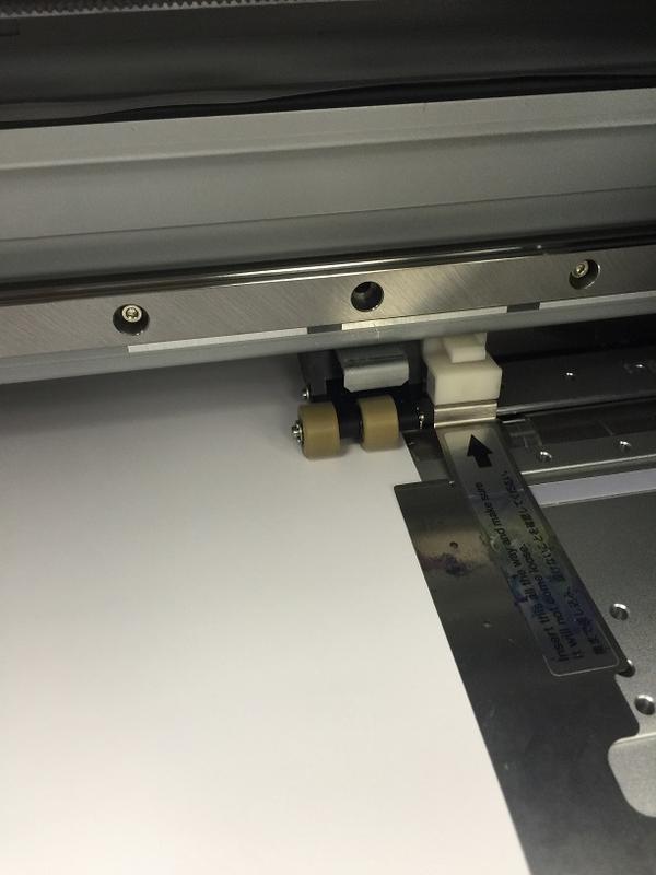

We to had a nightmare with the Roland XR-640. Intermittent starvation and banding. Come to find out it was neither. I noticed it occurred when the take up real engaged. Roland has come up with a shim kit. Their shim kit does not work. However I have come up with a permanent fix. I extended the pin on the outside roller and put two rollers on the end. Problem solved. The back pin on the roller housing happened to be the perfect length.
Very creative, we found the solution as you did and was posted 4 comments up about the takeup system causing issue with rollers feeding.
did you use an outside roller or middle roller?

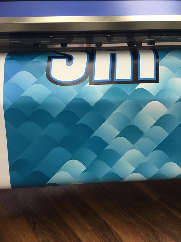

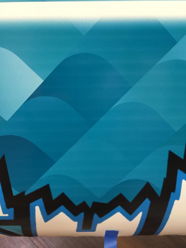

I added the middle rollers to the end. The before image was high quality unidirectional. The After image is Standard bidirectional. I have also modified my XC-540. Same results no band or starvation ever. Your welcome all Roland operators. I know how much this has cost us all. If you have any questions in modifying your machines contact me at robertsr@graphicsthatpop.com

Hope all is well and this is brilliant . Does this means , the outer rollers are modified to use two middle rollers with the longer pin ?
