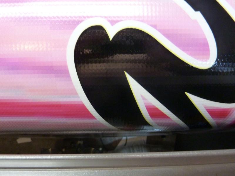

Hello I need help if you guys can! I have a yellow shadow on my prints. It is most noticeable on black??? It seems like it is off to the front and right of the machine facing(just like a drop shadow.....any suggestions???? Thank you Dennis

I had the same problem on my JV3 130 SPII awhile back and I tried doing a clean and everything and nothing helped so I ended up flushing the lines and it took care of it. Not sure why it did that but it was like my lines were getting mixed somehow. Regardless same problem here and it is most noticeable on black and if you print solid red it will prob be real faint and there as well. Just what I did

+1 on misaligned head. It is hard to tell from the picture if the yellow shadow is crisp or fuzzy. If it is crisp, it is 100% alignment issue. If it is fuzzy, it could be electrical issues or deflected nozzles.

I was getting the same thing on my JV3 but only it was showing red, do a 30 minute head wash and it should go away, mine did

Reset all values to factory and the yellow moved........
I reset values to factory and as I feared it is all out of whack!!!! Does anyone have an English version of doing the adjustments...not the manual it is a bad translation!!!! Why won't Japanese and Asian countries get help with translations??????

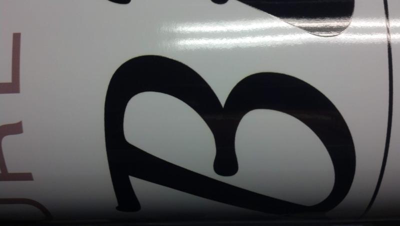

IM BACK IN BLACK.....so what the heck my yellow lines up with the rest yea Im back...ya Im back......Back in Black.......guitar........
