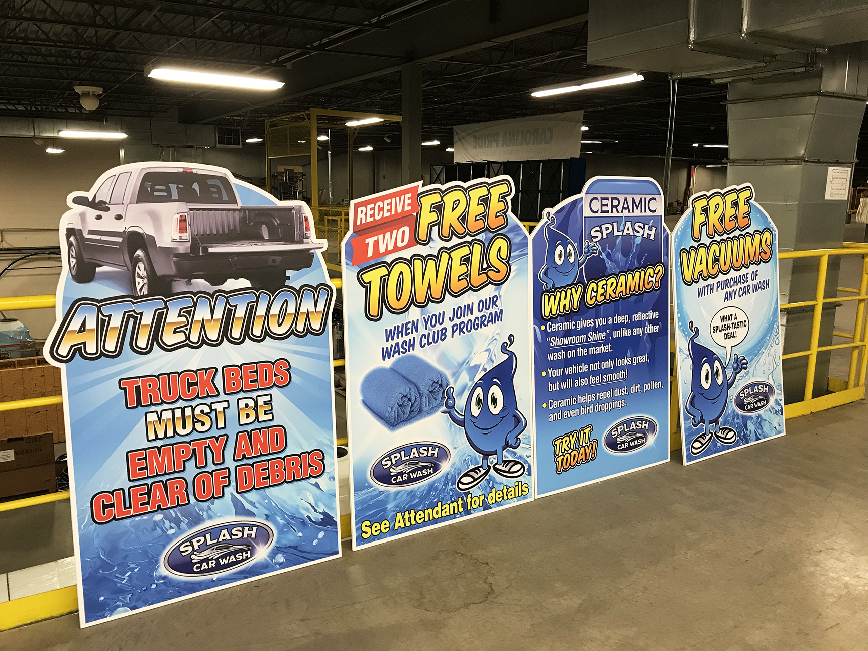

I ended up using a jig saw with a fine blade. Does well for cutting the curves, but had to sand away the fringes afterwards. It's definitely my go-to tool now.

do you mind if i ask what you charge for those?
we do a large (32" x 48") coffee cup with color graohic logo and 5 lines of text for a couple clients. we charge between $75- $95 print and stick, custom shape and laminated, dependong on quantity (typically <20)
are we charging too much, not enough? (the ship has already sailed for this group of clients, now that we set a price...)

Ours are about 36" X 58"-ish (depending on the graphic) and are 1 sided. We design, print on vinyl, laminate, then mount on coro and hand cut. We charge $135 for the insert, and antenna sign base is sold separately. These are normally only 1-2 in quantity. Wish we had a flat bed printer and cnc cutter to speed up the process, but we do fewer than a dozen of these per year.

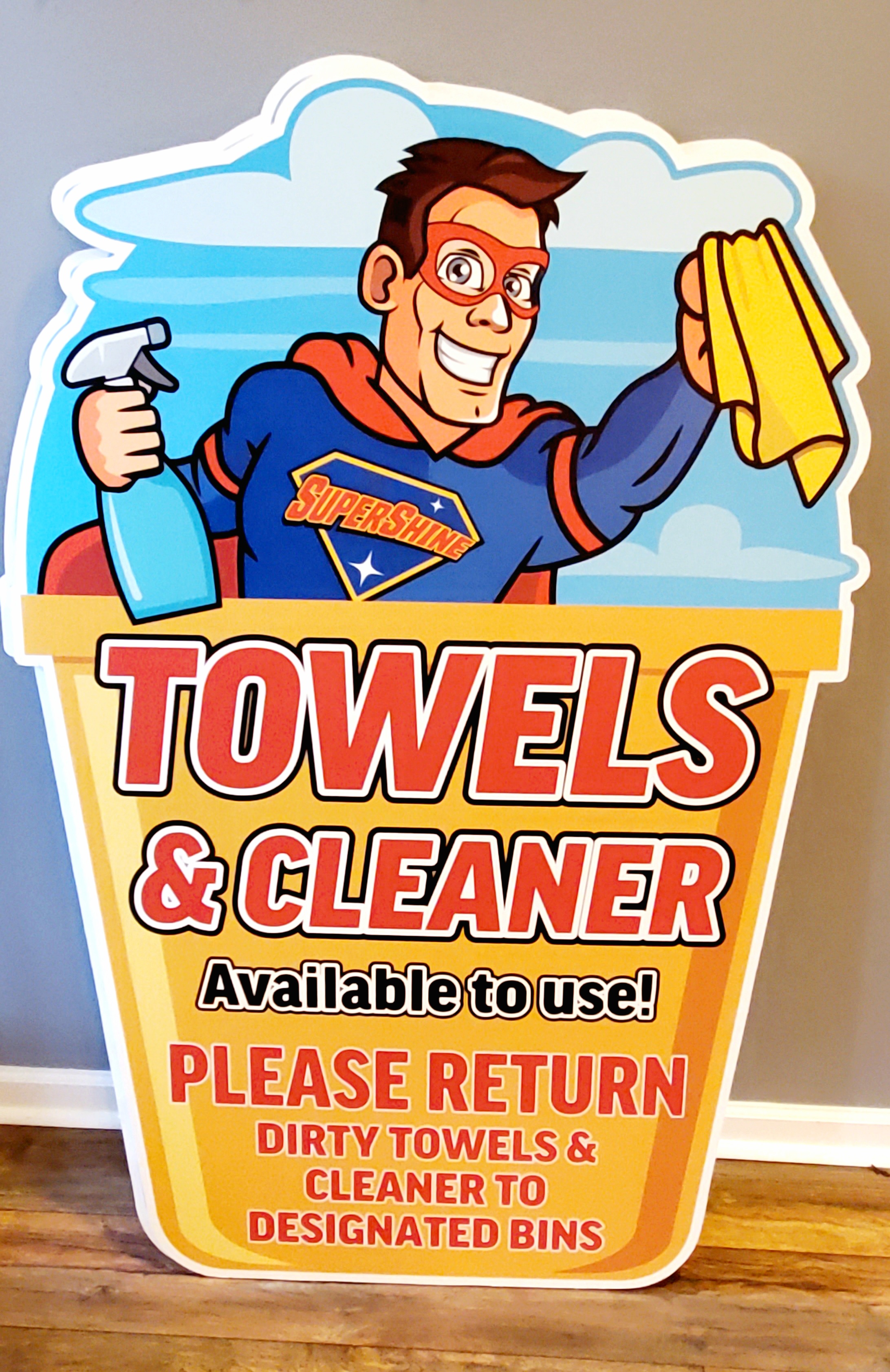

I also ended up using my 17 year old jigsaw with a fine-tooth blade... I sent the rotary saw back, it was too hard to control cutting through the thick plastic ribs of the 10mm coroplast, a machine controlling it would work, thus a CNC cutter. I had a lot of straight lines, sharp angles and curves to cut out, and the jigsaw did an incredibly good job. I did have to sand down the edges of the cuts in some places because plastic naturally wants to gather and "curl up" in lots of nooks and crannies from where it gets heated up and melted during cutting. So, because of that melting plastic effect, I found the faster I cut the cleaner the cut. But, that obviously means more room for error in cutting accuracy. I felt like I found a balance between speed and accuracy that gave me the best result with the least amount of sanding. This being my first custom contour cut 10mm coroplast, I was pleasantly surprised I could mount the laminated/printed vinyl on the substrate before cutting and the edges of the vinyl came out very clean. I think it definitely helps leaving a white margin around the entire edge of the vinyl to blend with the white of the cut coroplast. Here's a photo of the finished signs (2) at 38"x55", it's for a car wash.

Mine were close to the same size and I charged $125 each, but that was after my customer negotiated down from my original quote of $180 per. Their old vendor did something similar for $95 (without metal stand), and I'd never done anything like this one, so wasn't sure what the labor would be. $125 each ended up being well worth it once I understood the best way to cut them by hand. I however, printed these on adhesive vinyl, laminated, mounted on 10mm coro, then hand cut. A CNC cutter would definitely be nice, but if you're a noob to the industry, they can be pricey. If you did a lot of these types of signs, a CNC cutter would be a necessity.

For me no, I charged an hour ($100) for the design in addition to $125 per physical sign produced. So, I charged $350 total for the two signs. Nice thing is, next time they want another one for a new location, it'll be even faster to produce now I know how, and I'm totally fine with $125 per sign.

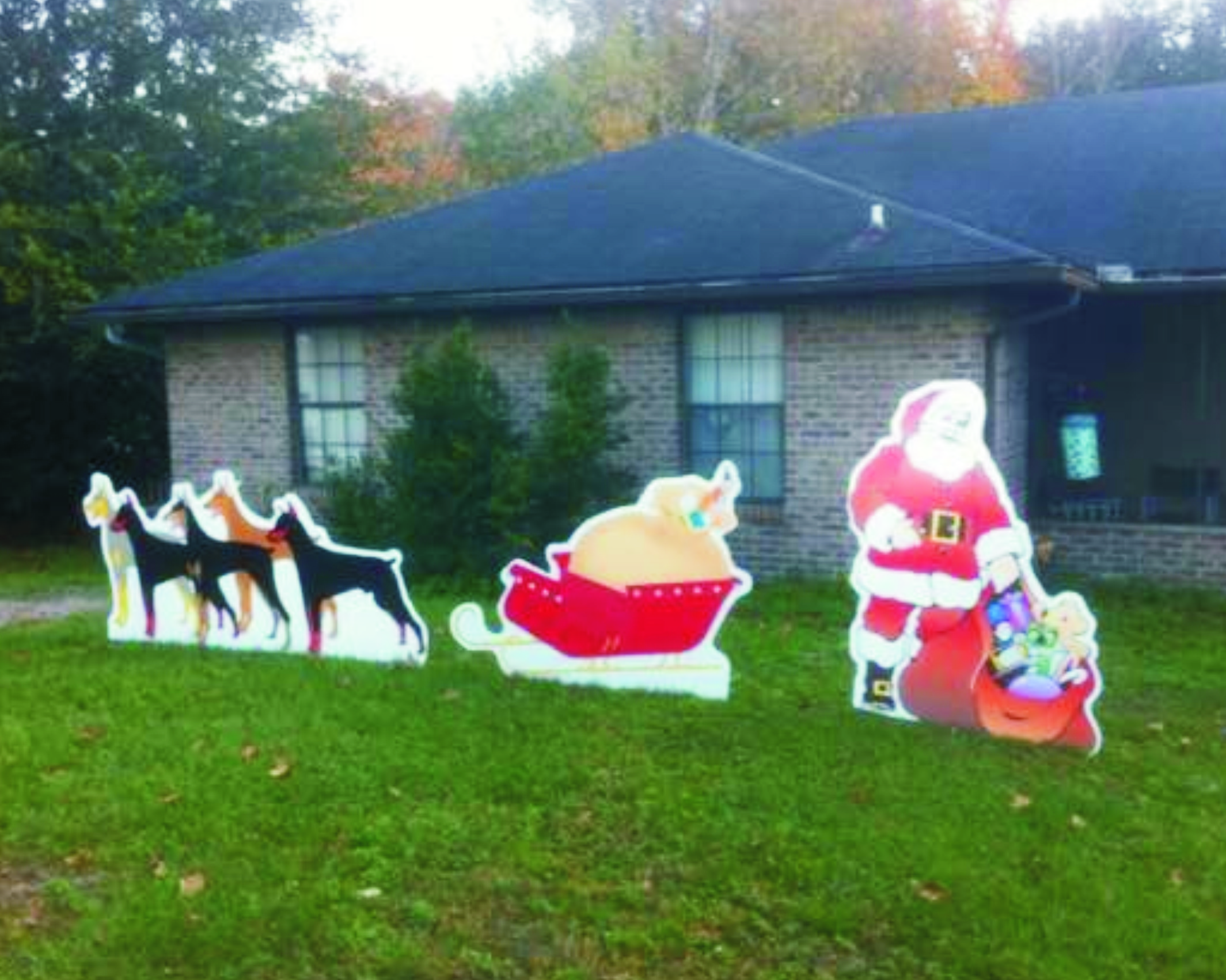

I've done quite a bit of 10 mil with print applied. I cover with transfer tape to avoid damaging print and knock it out with a jigsaw and fine blade. A cutawl would be great too. I use a sanding block to quickly knock burrs off and peel tape. If you are not doing a lot of this kind of work jig or cutawl should suffice. I have been using these at home for about 8 years now.
