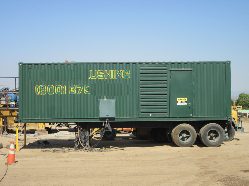

    This is the first time I've ever cut and installed a trailer with the corrugated sides. Is there a formula on how much longer the cut vinyl should be? Those corrugations look like they will shorten the text. And how much longer would an installation like this take?
    And...they used CALANDERED vinyl a year ago on this trailer and it is all falling off! Any idea how i should charge for removal? And how to remove. Everything in their construction yard has letters falling off...i was thinking about buying the powered vinyl removal tool.
    I appreciate any insite from anyone. I would really like this job to profitable and fairly priced for me and my customer. I know what i charge by the hour....i'm just unsure how long this one will take.

    I like the idea about the pressure washer. I'll check into the rental rates. The letters are about 17" tall by about 13' wide. I'm worried about the corrugations shortening the text. My buddy suggested i add 25% to the length. I thought that was excessive....except he's usually correct (i hate guys like that)

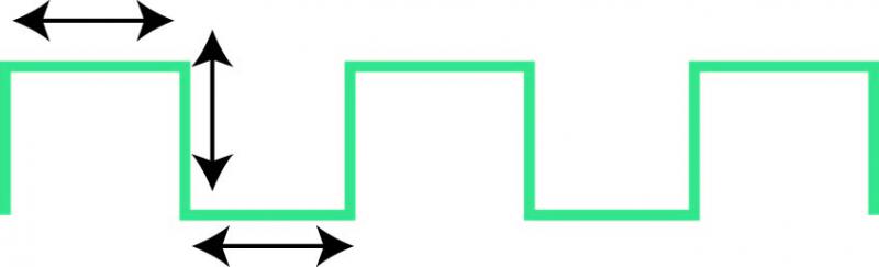

    never had to do this but i think if you measure the area including the corogation you should be able to use that measurment...i think

    As for 'shortening" via corrugation. Lay a piece of masking tape down to the trailer, going up and down the corrugation. Then measure out a foot or two (as the crow flies). and pull up the tape and measure it to see how much you've gained. Then do the math.

    Thanks Cross Signs! I'll apply a 4' pc of cheap vinyl on the corrugations and see what it measures out to. That solves it.

    Ok...we applied a 4' piece of vinyl onto the corrugation and we only lost 3"! Wow. I thought it would be more.
