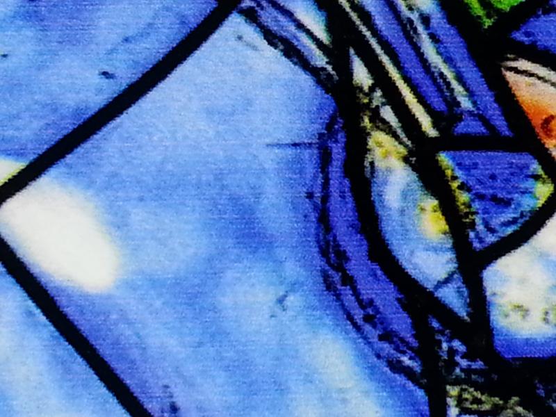

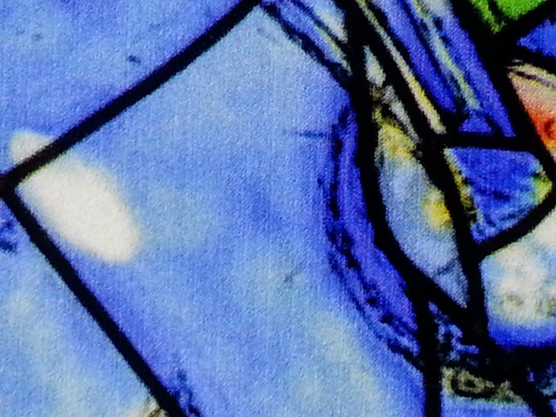

They use a Mimaki JV3. Initial test prints I receive from them looked very good. Attachments chagall-test1.jpg and chagall-test2.jpg are details from successive test prints that LightBoxes2Go produced as David and I worked to fine tune the colors. We were both pleased enough with the quality we were seeing to sign off on a run of 6 full scale 24"x36" prints.

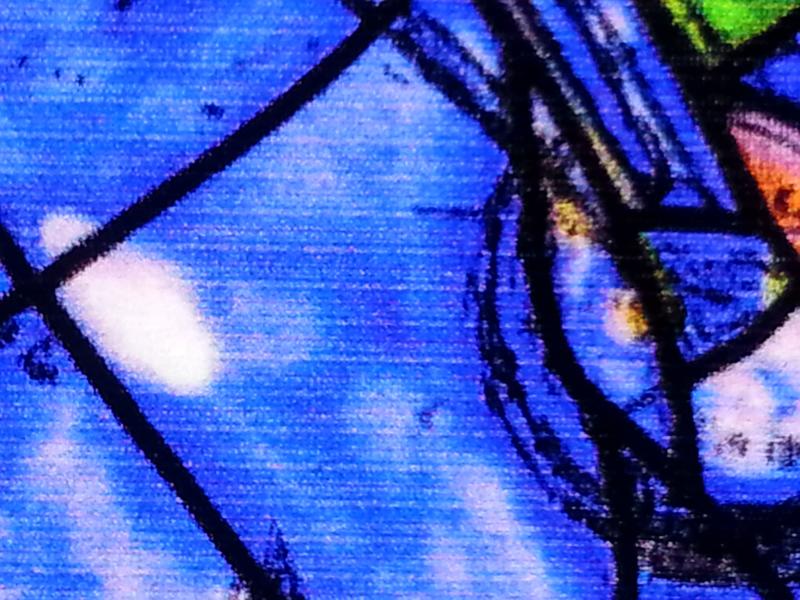

Sadly when those full scale prints came back the colors were way off and there were very obvious visual deficiencies. I would describe the visual deficiencies that I see as "tracks" or the stitching holes produced by a sewing machine. My I first fear was that those "tracks" might have been present in our submitted data files. LightBoxes2Go graciously has produce additional smaller scale test prints. These new tests seem to correct some of the color issues but I still see the tracks (attachment chagall-track1.jpg). Further the tracks are consistently about 1/16" in width irrespective of the size of the printed image. To my that confirms the the problem is not with the test file but instead with the printer.
I wonder if you, or anyone in you community who is familiar with the Mimaki JV3, on seeing my example problematic image, might be able to suggest what could be afflicting LightBoxes2Go's printer.

it looks like they are using 2 different production modes for the printing of a sample compared to the full size run.
the "tracks" are a media comp issue which most "turn and burn" printers could care less to address, i have no idea who the printer is, never heard of them...
also notice the head movement is going different directions from the sample to the full size, they should print a sample at full size, just a cropped portion of it, and see how that turns out
this issues is definately a printer issue, we can use two profiles on the same image and the colors will shift even more than that in some cases on our jv3.

yuck. so this is a print outsource that sends clean samples and then ships final product looking like that? Curious if it's related to one of our ongoing jv3 threads...
demand a refund, and feed him to a merchant member.
it's definitely a printer, and inconsiderate operator, issue. makes me sad.
pretty sexy graphic tho'. i'd love to offer to print it, if only to get my hands on that file :)

I agree with Wildside about getting a mag test/ cropped sample at 100%. I also think it's probably the printer and think if they output something like that as fine art prints they will likely just toss a slight gaussian blur on the blue sections and call it a day.

Although it is difficult to tell from some low res images some information is obvious:
  1. The 'tracks' mentioned are visible is both the test print as the final result
  2. Distance between the tracks in the test print is much smaller than in the final result
  3. The colors in the final result are much darker
  4. The black lines in the final result are less sharp
  5. The final result has more magenta in it
Based on this I think it is valid to say that both prints were made with different print resolutions (point 2) and different icc-profiles (point 5). The darker color and ragged black lines suggest settings used for the final result do not fit the media.
The 'tracks' are simply caused by nozzles not firing straight which can be easily solved by proper cleaning of the heads.

Above posters are correct. Media comp and different profiles in use.
I'll also add nozzle deflection to that list. It's evident in the final, finished print, as the gap from the media comp isn't the only unsightly pattern, there's also a concentrated overlap line you get when a nozzle is angled incorrectly, printing too closely to another one.
TL;DR:
1. Printer needs to adjust media comp, check their profiles, and replace a head before it costs them more refunds.
2. Client needs to find a new printer.

I agree with the others and think that this is primarily a poorly maintained printer.
