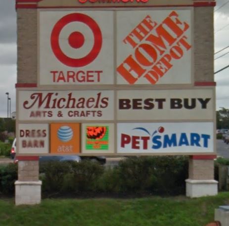

Sign I built and installed. Target & home depot boxes 10'x 10' each .080 metal faces with lexan rear. Originally used lords adhesive that was "supposed" to be made for such situation. Failed within 2 years. Used 3M VHB tape to repair an it lasted over 10 years before the entire sign was taken down in favor of a larger sign due to enlarging the shopping center footprint.
Was it my choice to build in this fashion, No. I would have gone with Flex face for something this large but the customer and his architect insisted on this along with textured surfaces that I disagreed with. Just because I disagreed with it did not mean there was not a solution to it and that is what I came up with to make them happy at that time.

Richard, did you read the OP's original information ?? You have such different elements and conditions, it ain't even funny. He has a single pole, 20' in the air with a double sided 8'x 8' cabinet.
You, practically have a building and I would consider that a single sided sign as to how those pylons are built. I personally have worked on several of those same signs. They are next to indestructible. You can amend it almost anyway ya want. The OP does not have those choices. Besides, you said .050 for him, but you used .080 for yours. Quite a difference, plus a weight factor.
So, again...... like I just said, what might work in one instance is not necessarily gonna work for another one, especially one with such different parameters. You are not comparing equally.
