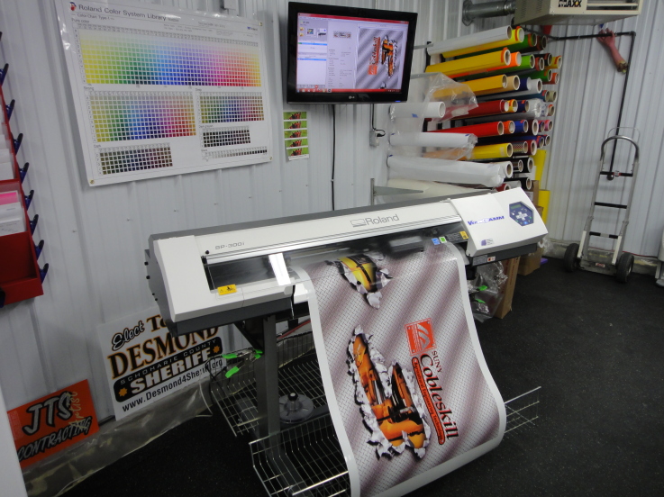

Anyone have homemade racks under their printer to keep prints off the ground?
J
john1
Guest
Seen this on another forum and was wondering if anyone knew where to get these basket type racks at and if anyone had their own homemade ones.
Looking to keep the prints off the floor when doing medium-long runs. I did a 18' graphic not too long ago and boy was that fun lol
Thanks!

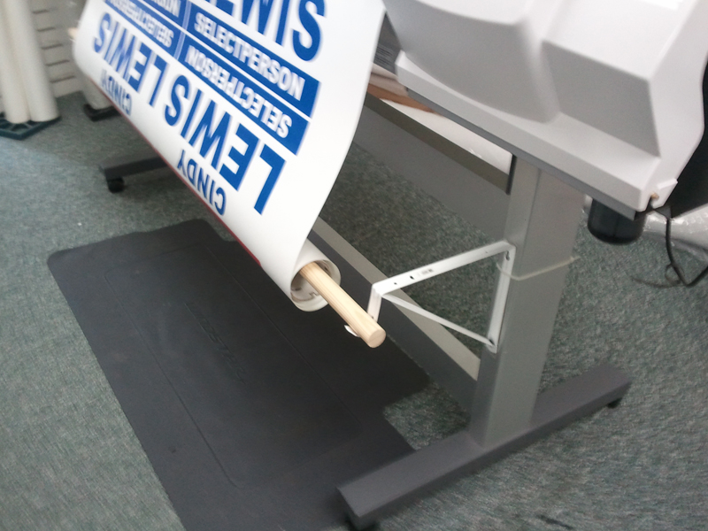

I made this one for my machine. Crude but effective. Brackets were like $12 each at Home Depot zip tied to leg with double stick tape. 1" dowel works perfect.

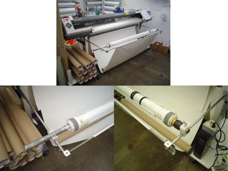

If I may ask.....what do you do with all those cardboard inner core pieces.?
They are 30" cores that go on my homemade winder- I would take them off
after they were wound and uncoil a bit and let dry that way. Now I have a
InfraRed heater and vinyl goes directly to the laminator normally. We don't
use as much 30" media as we did- more 54" unless there will be a lot of
waste.
Looking again at the pict- that is quite old- now the winder is powered with a BBQ rotisserie motor and triggered with a
motion detector- I will have to post some new picts.
Thanks!
Those are racks or bins you would find used as shelving for stores that sell pillows, bedding stuff. May find a retail store that does not use them anymore that may sell them. In my past life I managed a clothing store.
