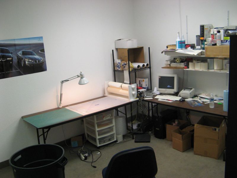

mnapuran
This is an OOOLD picture, but you can see the application tape holder I built years ago.
Similar concept to the Webermade stuff - http://webermade.com/
