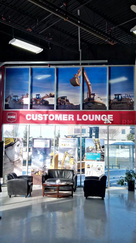

Consider printing to a double sided window poly media which allows you to either print to one or both sides.... then apply a double sided adhesive to the print and apply to window as usual.
