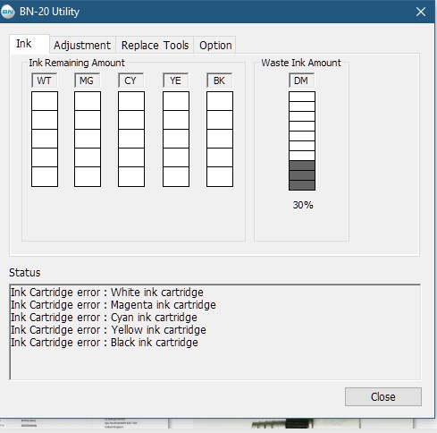

does anyone know how this is happened?
Im in the UK
And bought a used BN20

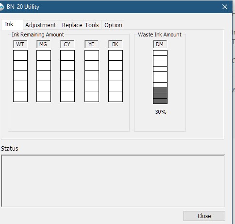

And inserted a brand-new ink tray and 4 x new eco-sol MAX Inks 440cc
and one new MT 220cc metalic
i haven't even started it yet but saying waste tank is 30% full?
what a waste of ink/money?
Adam

I ran a BN-20 with 440 carts, and it's fine. When the ink gets low, the tab will pop out and then you know you really need a new cart. As far as the waste tank goes, that's something you can take apart and refill with anything absorbent. There some good threads about that on it on the Googs ;)

I don't know about the BN20 but Mutoh did something similar. If you upgraded the firmware on your 1204 it would take the ability to read the 440 chips. Mutoh uses the same cartridge tech as Roland so I wouldn't be surprised if that's the case.
Sean@CedarHouse
Printing Money
Do you have your old cartridges? You might swap a chip from an old cartridge with a new cartridge and see if you get the same error.
I think the issue with the 440 cartridges is the weight. The ink slots don't have any reinforcement for the longer cartridges. Might look into making a little shelf to hold up the back side of the ink so the printer doesn't fatigue.
My 2 cents. Good Luck!

Here is what it looks like now

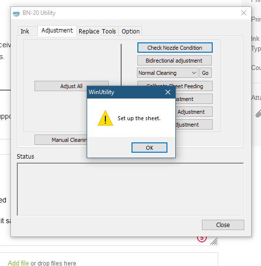

I also keep getting the message "set up the sheet" but its all been installed carefully and pinch rollers are down over the grip rod etc

And you can ignore the ink monitor for the most part. It's an educated guess on all Rolands. Best way to check ink is to pull carts and and/or weigh them.

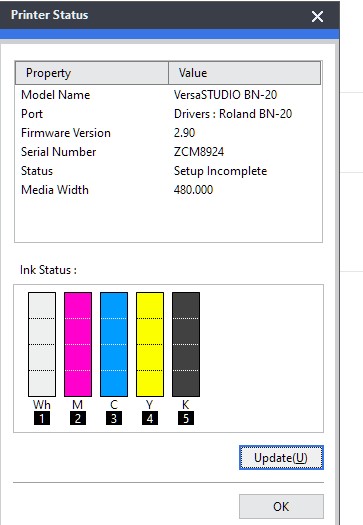

getting somewhere!

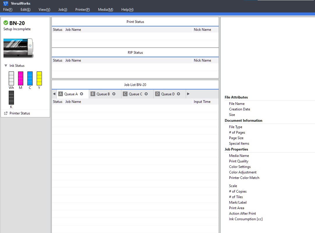

Ive updated the firmware, and noticed in the settings in versaworks that WHITE Ink was previsouly used, so im thinking i now need some 220c white ink!

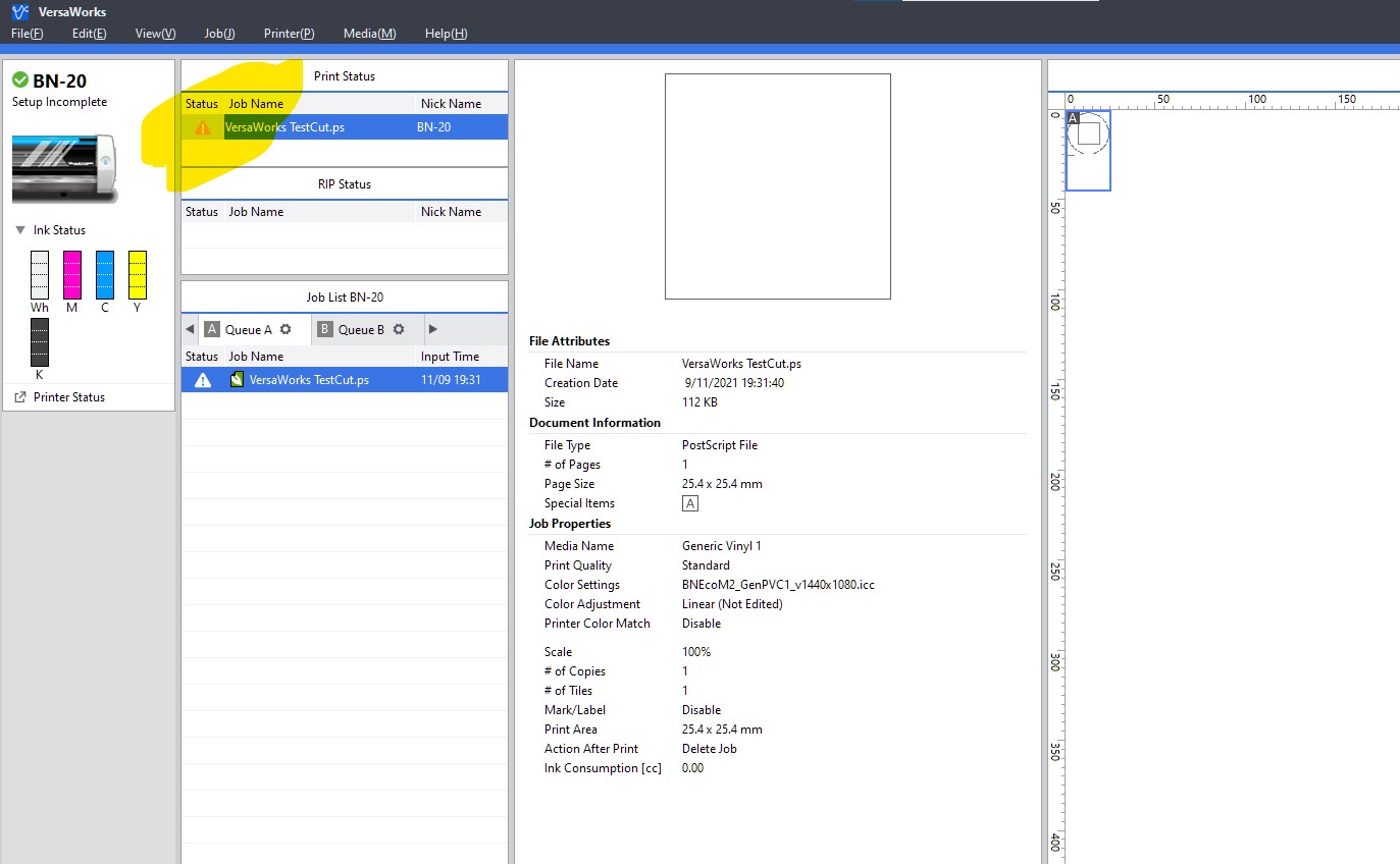

I have just tried to do a test cut and a test print but it wont move
Does anyone know why? it doesnt do a test cut or test print?
SignMeUpGraphics
Super Active Member
It shows "Setup incomplete" in the upper left. The machine isn't ready to perform the job.
As above, check that media is loaded correctly first.

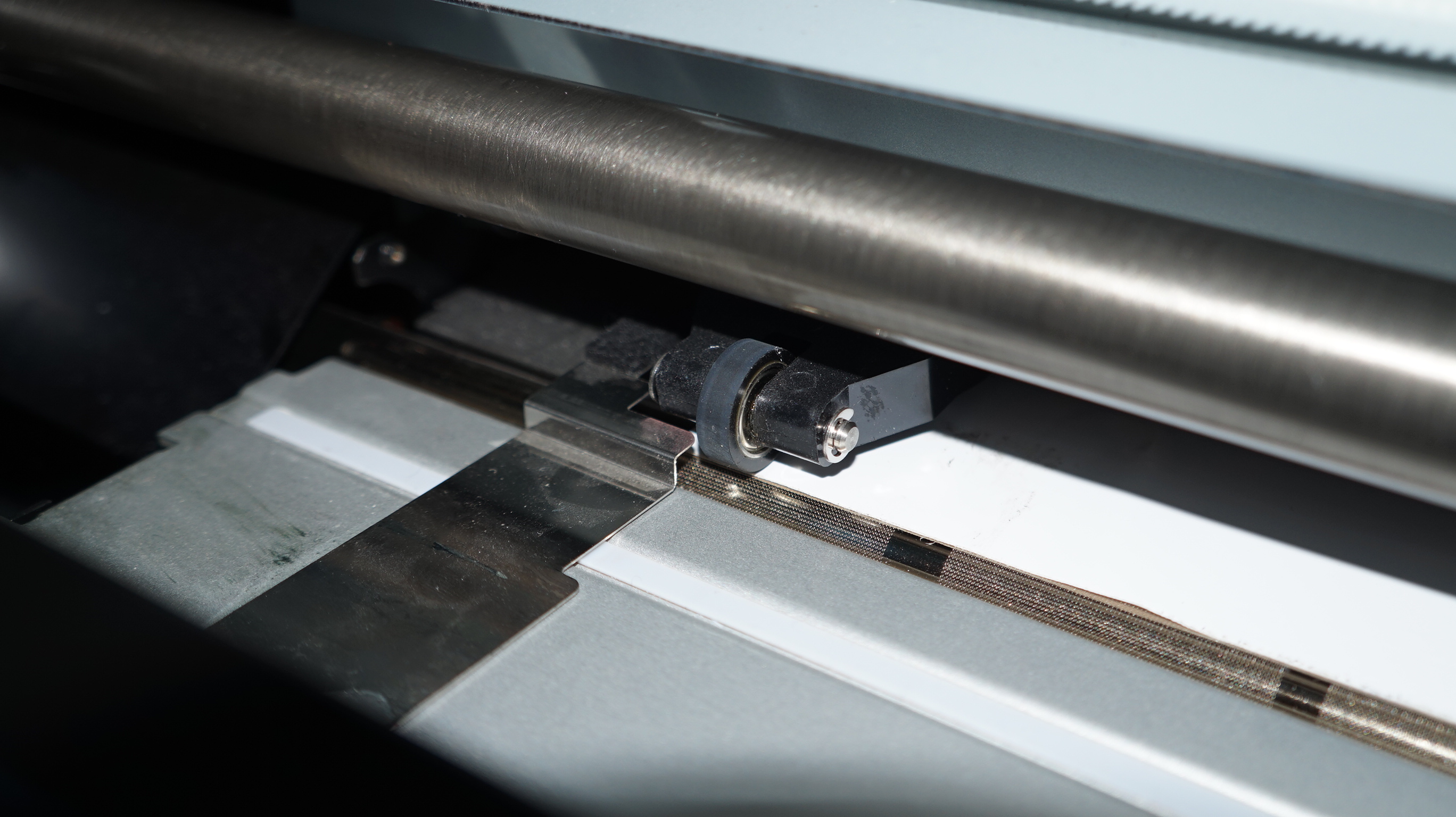

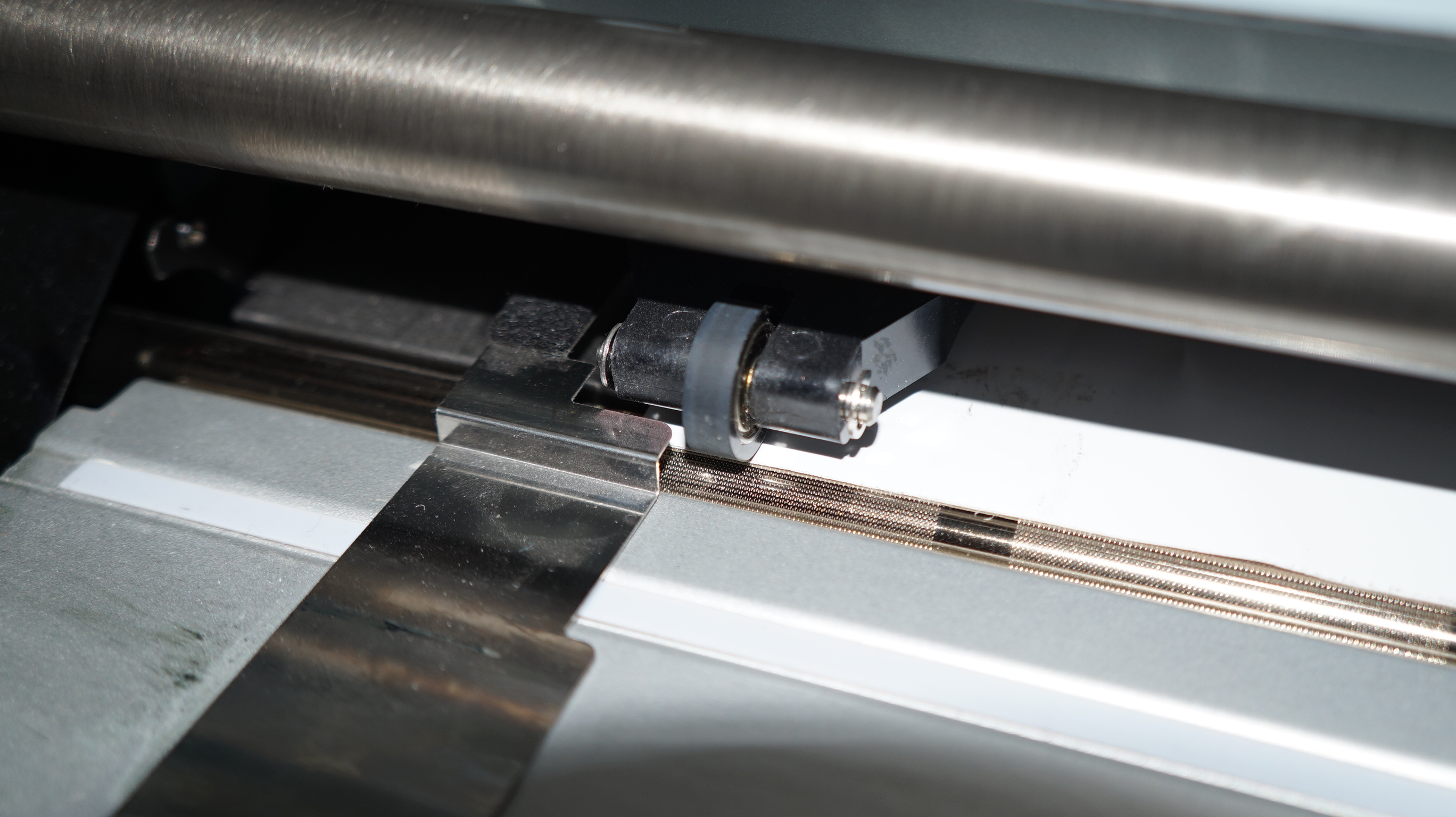

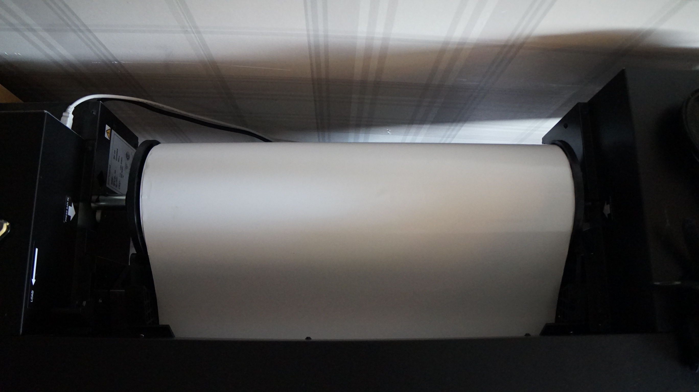

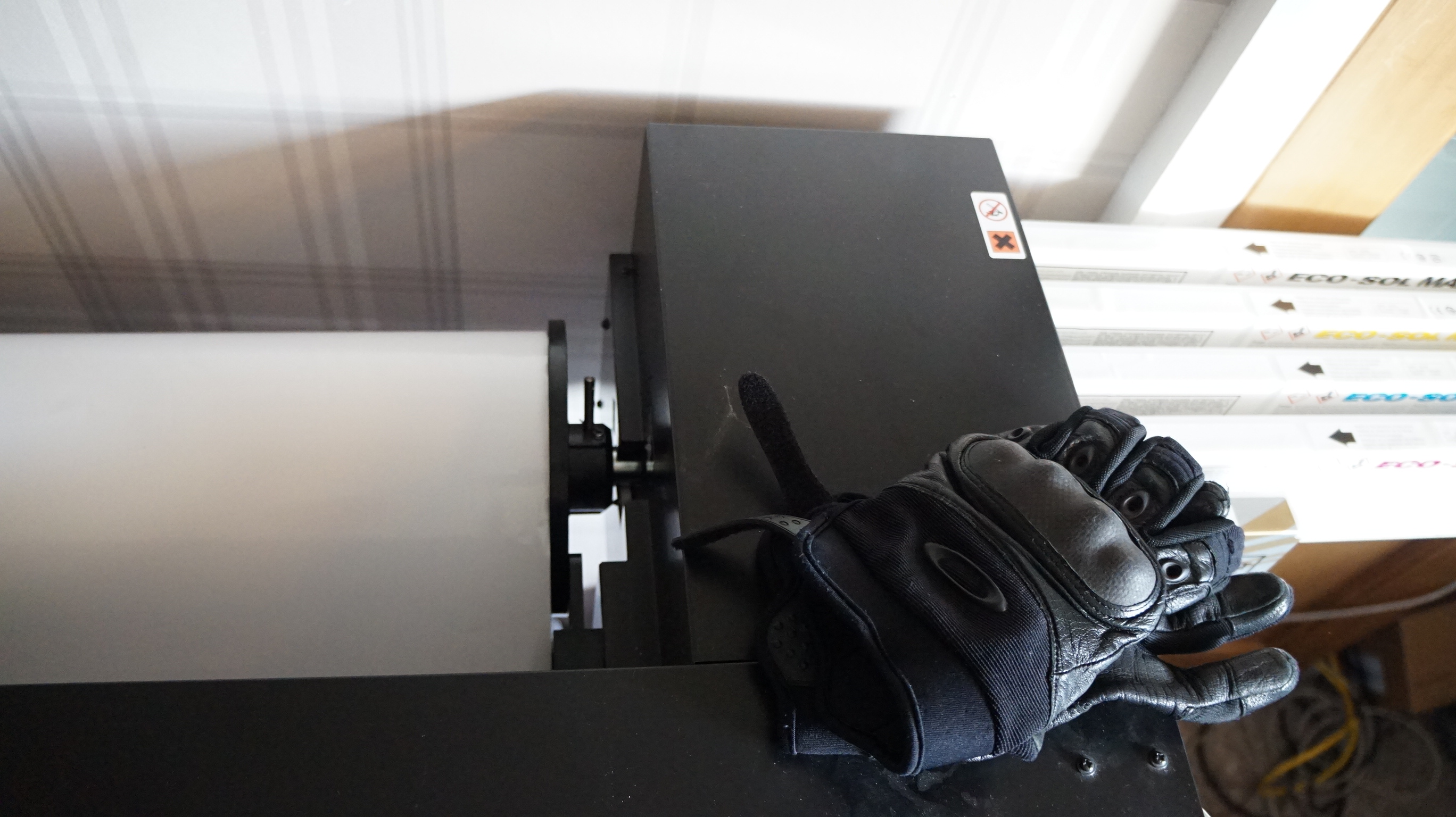

see pics does it look okay guys?
Note: the first 2 x pics show the rollers are lined up with the grit roller
Of course the paper then gets pulled right through after those pics were taken, just to show if it looks right DSC00300.JPG DSC00299.JPG DSC00303.JPG DSC00301.JPG DSC00305.JPG

There is no setting to change. Once you pick your spot color your stuck with it. So if there is a metallic cartridge in a white channel the chip is going to prevent you from printing.

There isnt much info out there about people changing from White to Metallic, Im assuming you have to get Roland engineers to do that with software?
Im sure this printer is set up to use eco-max 3 inks with one x white!
I got the printer used with no inks in it and assumed ECO-MAX Inks with metallic would work! But they dont get found in Roland Utility and in versaworks shows White and eco-max 3 inks
