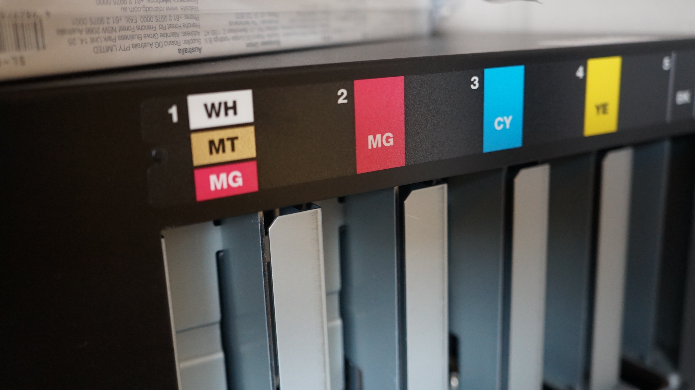

On my printer it says on a small label
WH
MT
MG
So i thought i could add MT And didnt work
Says on versaworks WHITE and eco sol max 3 so i assume thats what was in it last? Unless thats just a default type on Versaworks
