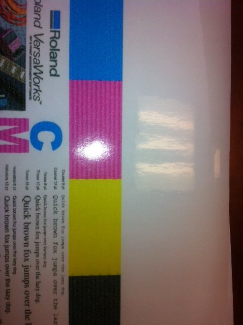

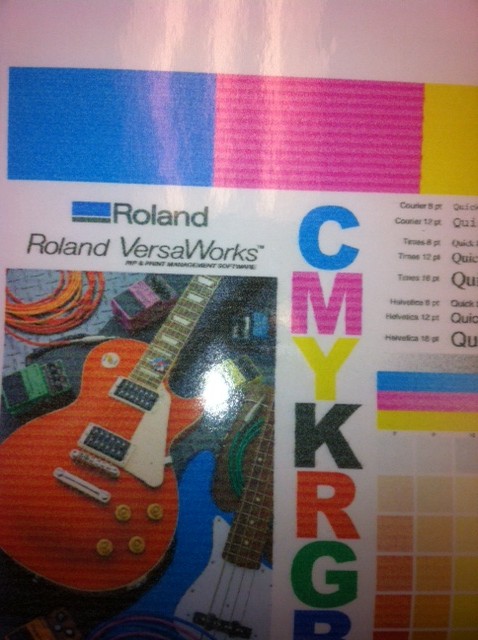

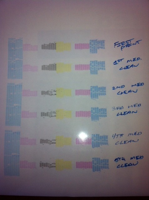

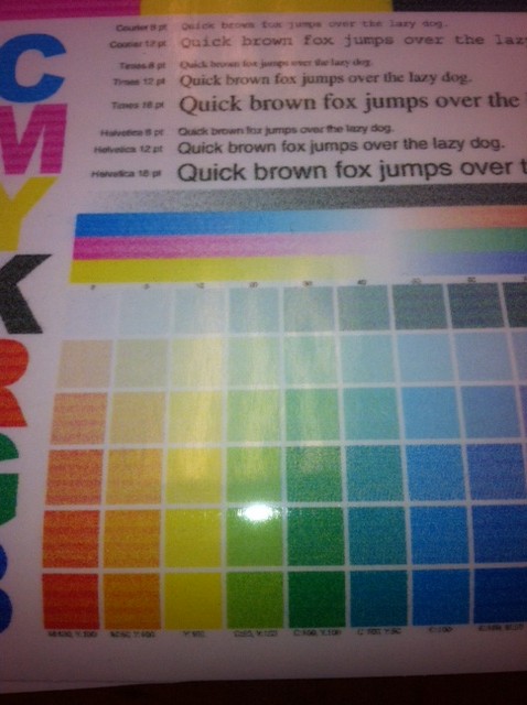

Test prints... Also, these prints look pretty vibrant. It must be the flash on my camera because they don't look quite this good...

Yikes! :covereyes: I'm no expert... but it looks like you need all your heads replaced. That is one baaaaaaad test print.
Tigertron
Have you tried the deep cleaning. But those heads look bad. I have some old ones that would print better than those. Since they are shot I would see if soaking them in cleaner might soften the ink enough to flush them out. Looks like they dried up.
UtahSupra
Sounds like a head soak are in order, any advice on doing this?? Also I've heard/seen some people putting that DX4 head in a ultrasonic cleaner with some solvent, any thoughts on that??
