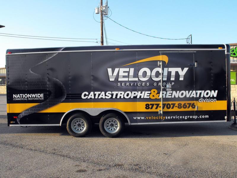

Hey Forge, Thanks for the expertise! Those minor adjustments look as if they could make all the difference! Now I just have to make sure my measurements are right on!!
Yes, the measurements are very important because the tolerances of the text are very close. I would make very accurate measurements of all interfering items, like the door frame, trim and hinges, etc, and either create my own full scale AI template or adjust the template you are using to be as accurate as possible, because often they are off just enough to cause you problems on the install.
grafixemporium
Nice design. Looks great. We do our best to make sure not to lose a significant part of a logo or a complete letter in various obstacles of a wrap. In this case, you could have definitely wrapped the door frames. If fact, it wouldn't be difficult or terribly costly to go back and add those frame pieces back in. On the next one, wrap the frames. They stay down just fine and the finished product looks great. I can't say we wrap the frames 100% of the time, but in situations like this I would either tweak the layout or plan on wrapping the frames.
Here's a pic of one where we wrapped the frame so we didn't lose too much.

Looks great. Can someone tell me what the name of the script font is used for the tagline? Looks very familiar but cannot seem to locate it.
Fitch
Another hour and a little paint from a master signwriter could fill all those missing letters.
