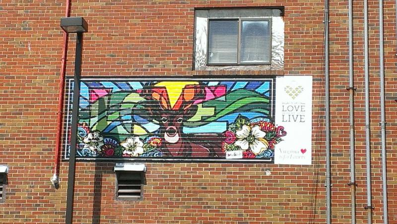

I have a customer wanting to do a mural on a brick wall (image attached). I have never done an install on brick before and have never used any type of brick wall vinyl material. I know Arlon, Mactac and 3M (probably others) make vinyls specifically for this application. How well do these materials work? What type of longevity should I be expecting (6 months to 3 years?). Also, as shown in the picture there are several runs of conduit going vertically up the building, are these going to cause problems or should I be able to work the vinyl over top of these with no problems? Any input would be appreciated.

Just found out that they are looking for this mural to last only 1 year. So paint isn't going to be an option.
I was required to give them the 3M bulletin for 8624 and apparently it mentions that freeze zones could cause problems and also that there could also be a problem with mold from water seepage. I can't imagine either of these being a problem, am I wrong? I am also assuming these leave no residue (or damage of any kind) behind on the brick wall after removal?

Just wanted to post an update for this project. Finished it up today. 6'x16' graphic took about 2 hours. We used the new Envision Wrap material and it ended up being pretty easy. The material seemed to be sticking really well. Had to buy the TSA-4 roller from 3M which was a total rip off but worked really good.
