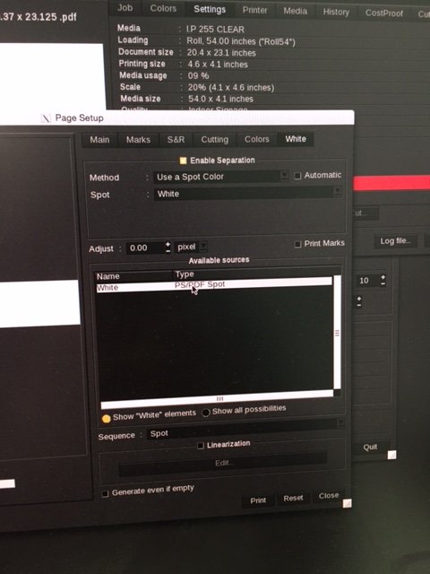

Trying to print a spot color of white in caldera V9
File is set up as a PDF with "spot color -white" CMYK
Its printing a full flood of white and not the shapes created.
Any help would be appreciated.

Their is an option to specify what white you want, spot, underflood, and over flood. IIRC it's under one of the tabs from you image window/panel.
Stella_FB700
I have everything set up - please see picture. Just for some reason its printing solid and not the actual shapes.

I would call their support line and have one of their people log onto your RIP and take a look. I don't know if they have a number for Canada but in the US it is 612-216-5212
ProColorGraphics
I have never had that issue and curious as to what the problem is? Also, I don't think V9 is supported any longer either if I remember right.
Stella_FB700
Turns out i have V10 - didn't think i upgraded.
But the issue was basically using the white mode i needed to use the print mode "photo" and nothing else.
Everything else registered into the system.
"Had a idiot moment - just had to play with the settings - haha"
