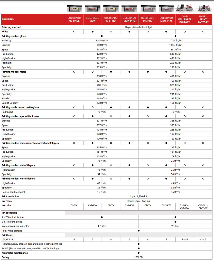

Can someone please give me the rundown on all the option available so I can read my quote correctly and know what I'm comparing to?
Thanks
victor bogdanov
Thanks
https://www.usa.canon.com/bin/canon...rado-m-series/Colorado M-Series Datasheet.pdf
Ink is more expensive on the M3 vs M5 so keep that in mind
bpp
Ink is the same, bottle sizes and price per ml are different. You can't upgrade the m3 to the larger/cheaper per ml ink bottles.
You will not get any ink cost advantage with the m3 over competition.
So if I don't need white and don't do a crazy volume I should not go for the Colorado? I wouldn't want the larger inks because they will expire on me
victor bogdanov
It is not a cheap machine, service contract costs as much as buying a new Epson or HP or Roland almost every year...
Not the best choice for low volume
