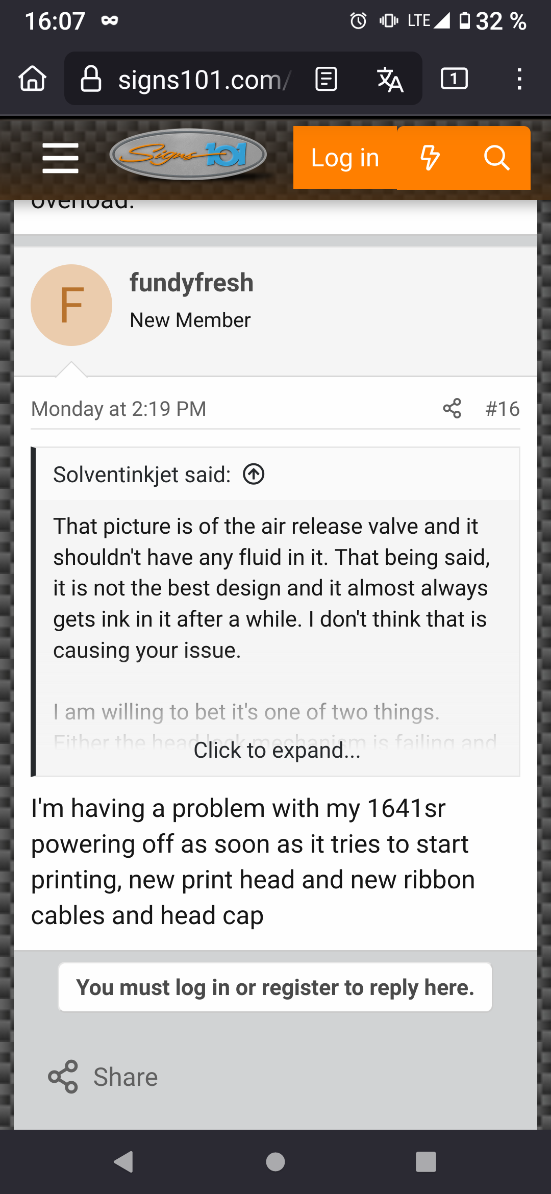

I'm dealing with this right now. Mutoh 1641sr. Printer was in complete working order except the magenta was toast. Ordered a new printhead from solventinkjet. Put that in, got halfway through a test print and got a head temp error. After that the whole machine shuts off went it starts to try and print. They recommended new cables. So I did cables and new fuses just to be sure. Same problem. Had a tech come by today and said everything is good, but the new print head is bad and tested new and old fuses and all were still good.
