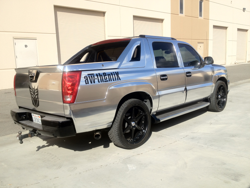

Install sucked. It has seams. I won't lie.
Media: Polyester adhesive backed film.
Working on blending medias together as to not fork out 2k for a roll of Avery.
I didn't want mirror shine. Eww. I like this finish better and that's why I didn't polish it.

Bro, tell me you didn't go cheap chinese. You know how I hate that. Seams in the chrome? Yeah you can't lie about that. This was the PERFECT day until now.

You can't see seams in chrome. Too thin. Plus.. Strategically placed in body lines.
See.. Wait you can't

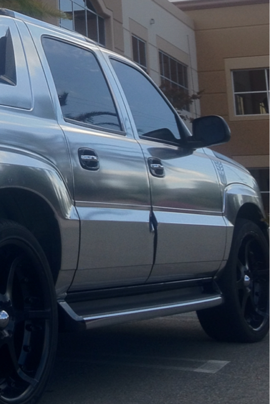

I agree the finish you chose looks the best. nice install work too! How well does the vinyl stick the the textured plastic piece behind the rear doors? Or was your model painted there?
JoshLoring
Sticks fine. All Of the Cadillac EXTs have painted plastics. It's not texttured either.
