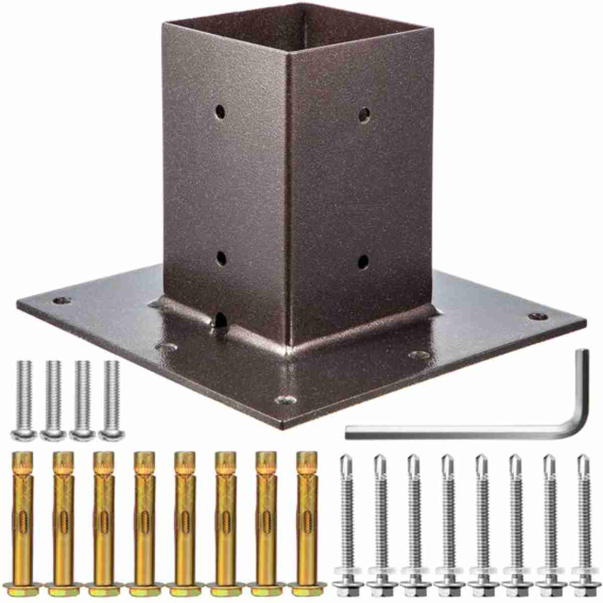

Safe bet with aluminum is doubling down on steel thickness/dimension. Sure its overkill, but more often than not you're doing something you probably shouldn't, might as well overshoot.
Don't forget, they are in FL, so they require hurricane ratings for wind load. Not certain on signs but found where it states structures will need to withstand 165-195 mph gusts. Does that change your calculations any?
It would. Ours are based on a wind speed of 110mph, exposure C.
In general we just stay away from using aluminum posts. In 22 years, I think we've done it once. Luckily we're in an arid climate so painted steel is usually just fine. If a customer was really pushing for it, I would probably use a thin wall aluminum post sleeved over a steel post so the aluminum post would basically just be decorative.
