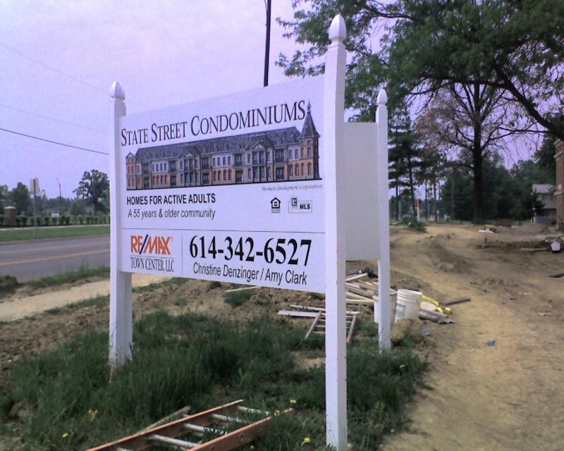

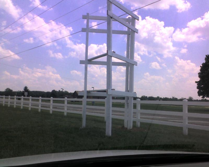

4x8 site sign frame options
Variations on the site sign. "V" style and Vert with two 4x4x12

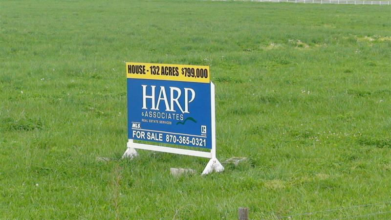

Can't see it for the grass but I have built a few. I gave them steel stakes that would hold it down but they used the blocks.
