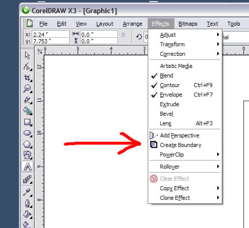

Again, I see no command called "Create Boundary" under the Effects menu. I don't see it in V 12 either.
You mean you don't see this? Are you using a workspace other than the default Corel workspace?

In newer versions of Draw, "Create Boundary" also appears in your tool bar when you have more than one shape selected, next to "weld", "trim" etc. etc.. (oops Jhill beat me to it)
The thing to know about Create Boundary is that, as it's name implies, it only creates a boundary around your shape, it will not create a path on lets say the inside part of your "A" example.
