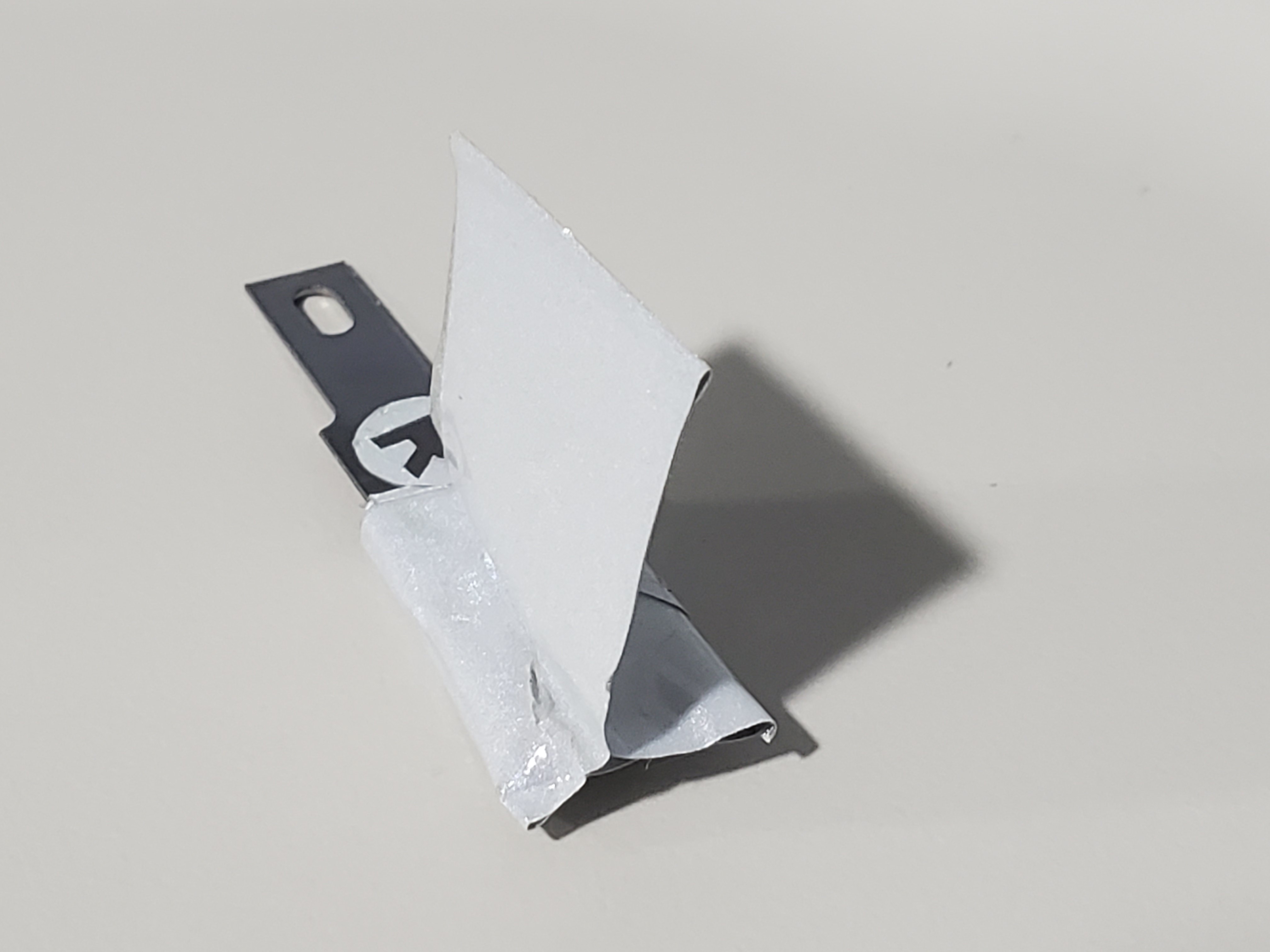

Very interested to know how this works...!
Hold the flap with your left thumb and forefinger, place the hole over the letter your plucking from, which holds down the rest of that letter. We have a recurring job that has a 1/8" tall Registered Trademark, a circle with an R in it.....on white reflective. Nearly impossible and not profitable until I came up with this contraption. Takes less than 5 seconds per R.
