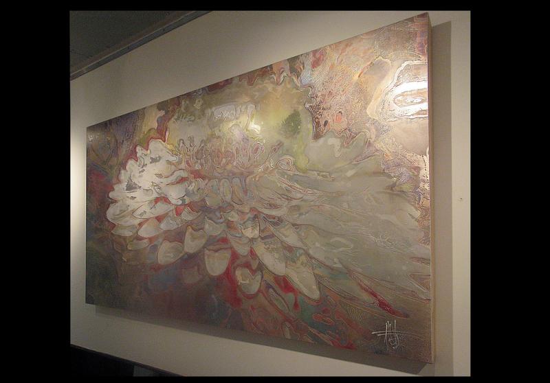

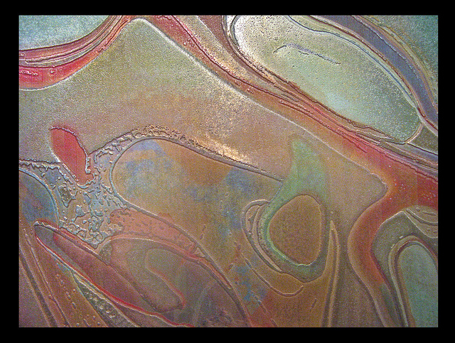

compound mitered bases
also, this is some nifty stuff you can do. this is a 3" deep compound mitered "look" base with aluminum top. cut with a single pass at an angle with the tracksaw. the edge left behind was so smooth and perfect that sanding with 600 grit would be a waste of time. very tricky with a table saw, actually dangerous. but with a tracksaw, you don't even break a sweat.
a $6000 piece of aluminum is a scary thing go chop up. this is why i need a tracksaw. the etched resist pass and color/white done with a jv3.

nif·ty   /ˈnɪfti/ Show Spelled [nif-tee] Show IPA adjective, -ti·er, -ti·est, noun, plural -ties. Informal .
–adjective
1. attractively stylish or smart: a nifty new dress for Easter.
2. very good; fine; excellent: a nifty idea.
3. substantial; sizable: We sold the car for a nifty profit.
–noun
4. something nifty, as a clever remark or joke.
i would never go as far as to say that my own work was "nifty", fine or excellent...but especially in cases of 'art', i would leave that up to my clients...i would also not go as far as to tell an artist that their work was crap, even if that was my opinion as it is obviously subjective.
nothing like tootin your own horn.....beep beep.
