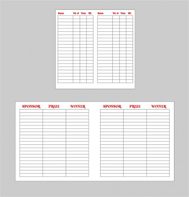

Colin
May I ask how the finished product looked over the coro? I was concerned about all the lines.
Just fine. Very glossy though.
And while I am already typing, is it feasible to cover over old dry erase boards with any variation of this material? Is the transparency a speedbump?
In that case I would use the solid white dry-erase film, because usually an old, used board will have residual markings, and this clear film would not hide it.
*I actually covered over a gray vinyl grid (see attached). My original plan was to cover the entire sheet with the dry-erase film, then put the grid on top, but then I thought that the gray grid would get all marked up from the pens, so I put it on first and then covered it (+1/2" bigger than the grid) with the dry-erase film. It worked!
