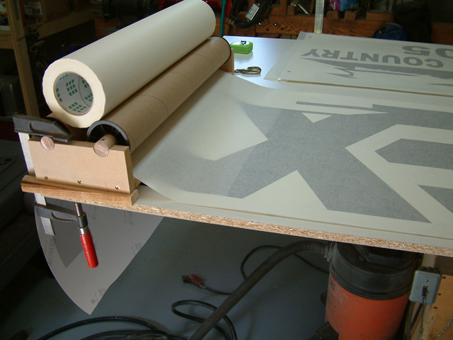

Here you go Jill. This works great and you can build it out of trash. http://signs101.com/forums/showthread.php?t=8249
With two rollers you just plunk the tape on top....no threading a stick through the roll. Long graphics go under the holder so you can tape any length.

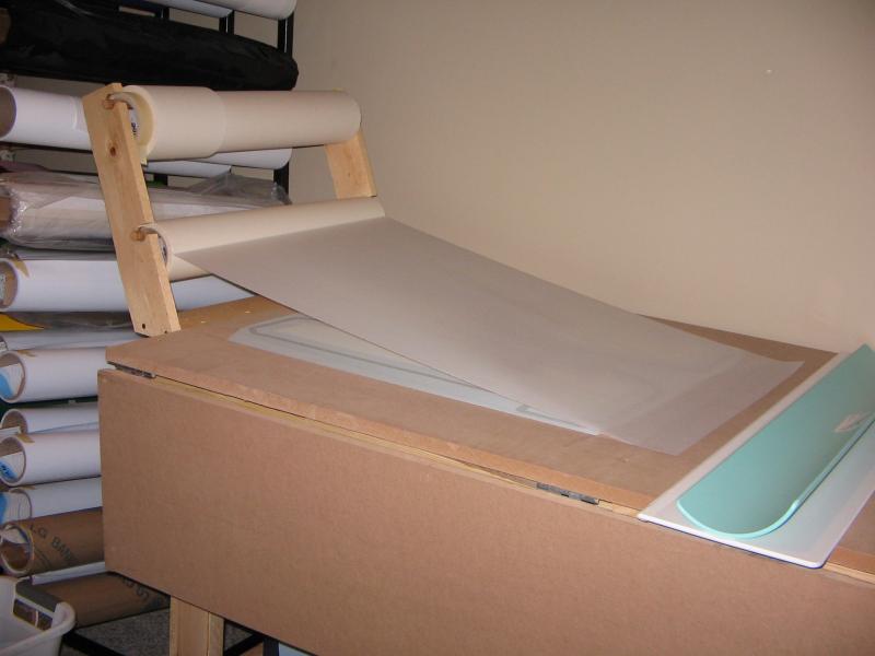

I bought some things from Henry Goines, a merchant member here... I just keep them on a shelf and then clamp onto my table when I need tape. 24" wide.... I have the CE5000-60 also. The BS works great too if you can keep pushing it straight.

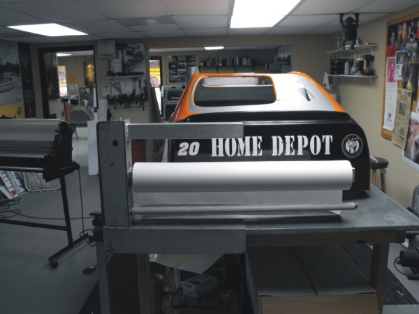

Right along the line of some of the other handmade pieces shown. Small roller at bottom keeps tape close to table.
