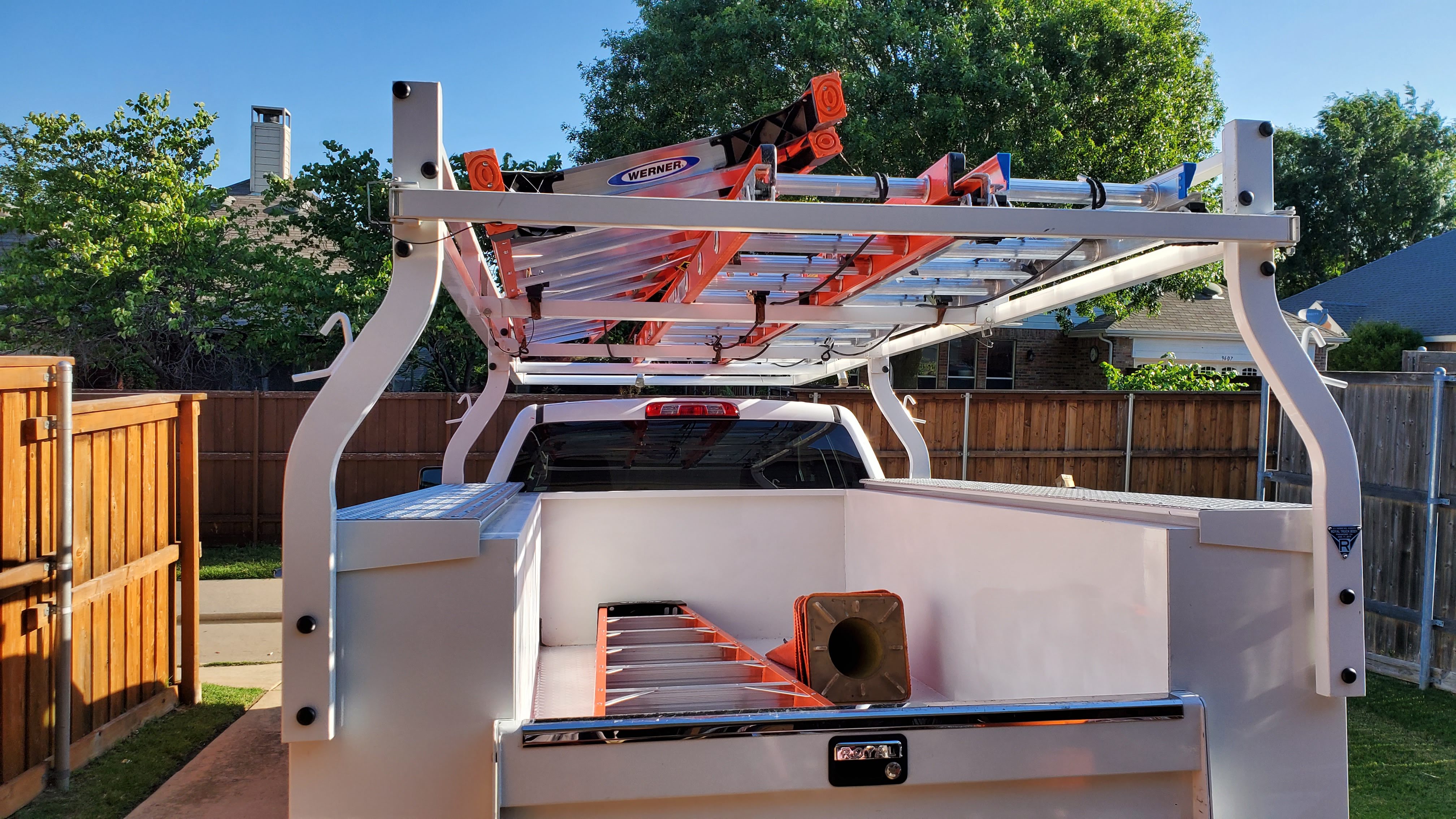

Well, here is an update 3 years later. The ladders stay on the top of my truck and get sun all the time. It's not practical to take them off and on, or cover with tarp or park in a garage.
Twice a year I spray them with UV protecting acrylic clear coat.. as per the manufacture specs. https://www.amazon.com/gp/product/B00397STRW/ref=ppx_yo_dt_b_search_asin_title?ie=UTF8&th=1
They still have color (though it's more red than orange) and there is no itchyness to them... so it is lasting longer. Every time I spray them the color comes back.
