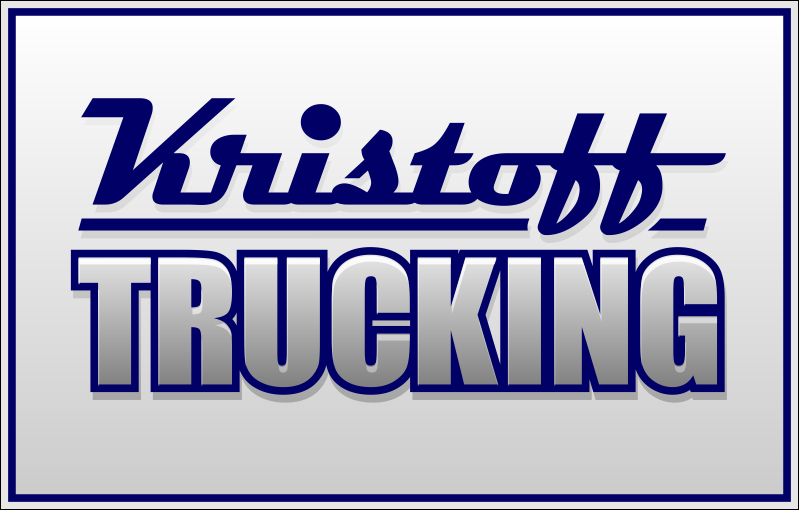

lukewarmtea
Sorry I should have clarified earlier and I think I posted this under the wrong forum it should be in design and layout not logos. I'm designing a sign for him to put on the front of his building, not necessarily a logo. I will post more ideas once I'm finished with the book for you guys to judge!
Jillbeans
While the script font can be OK on some retro signs, it reads as f*cking to me.
Try it for the name, kerned tighter, and use a simple font like Impact for the trucking part.
Yours looks kind of MS Paint-y to me.
Glad you got the Mike Stevens book.
Here's a quick suggestion.
Love....Jill

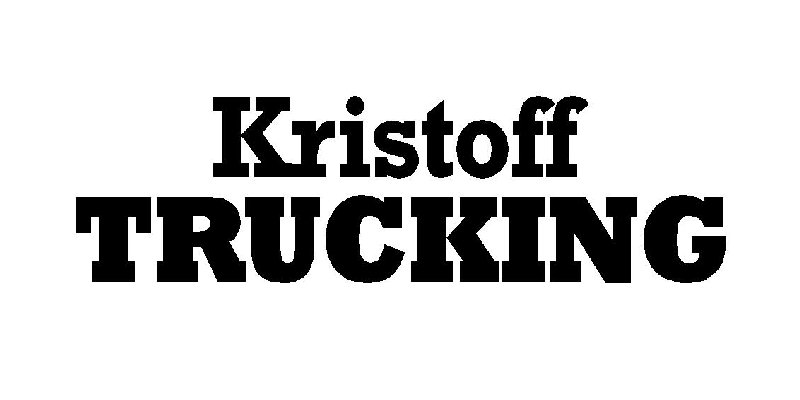

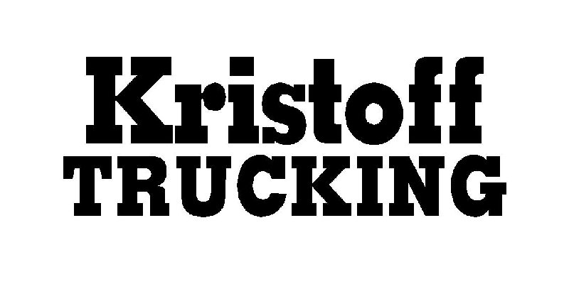

lukewarmtea
Revisions
As I read this book I'm going to post updated examples trying to implement the theories as I learn them.
In this example the spacing is better I hope. The proportions between the upper/lower and side boundaries should be close to right. The bottom word was capitalized to create a smooth line for the bottom of the top letters and therefore reduce "negative space discordance". I kerned the words a bit too, hopefully reducing confusion between the letters and the background. I also don't believe any of the letters contain too much trapped negative space.
Any thoughts, did I kern too much, is my spacing off? Sorry about the font, I only chose it because he uses it on his truck door decals.
lukewarmtea
Very nice Jill!
My explanation for the poor color quality is I'm designing these demos in a vector program and flood filling them with a paint can. Ultimately I will be routing out the sign on a CNC machine so image/color quality isn't my primary concern. At this point I don't know any better :banghead: Maybe I should be using different software!
lukewarmtea
A question I have is it okay for my exact optical center to be between the two words? It seems to keep my formatting right my optical center is pretty much negative space?
lukewarmtea
One last question of comment on my latest design is the bottom word has a bit more spacing between the letters, therefore a bit more negative space. This makes it somewhat harder to read, monotonous, whatever you want to call it, but ultimately it directs your attention to Kristoff at the top. At least this was my intent, opinions?

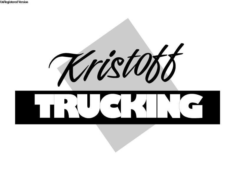

Dave Drane
What word do you think should be more important to read?? "Kristoff" or "Trucking"??
What do you think would be more important to potential customers?
Jillbeans
#33 is a great start. I like doing the top line in lower case and the bottom in all-caps.
I am glad you are studying that book.
lukewarmtea
Ahh yeah I forgot about the psychology bit. I suppose they want to know what the business does.
Is this any better?
lukewarmtea
Neat idea with the tilted box Dave. Hey what fonts are those? I'm not sure if this book explicitly lists the proper fonts yet, I think it's orientated toward people hand painting more rather than myself with a font browser.
If you guys don't mind me asking what is a good go-to font for industrial business type signs? Helvatica? San Serif? Rockwell?
lukewarmtea
Dave in your example did you angle the scripted text? I'm trying a version with the top being scripted and am having issues with the bottom of the lower case f's interfering with the text below it.
Jillbeans
^^ that's why I added a rule line in mine.
You can overlap sometimes, but you have to be careful.
Probably not for something which will be routered.
