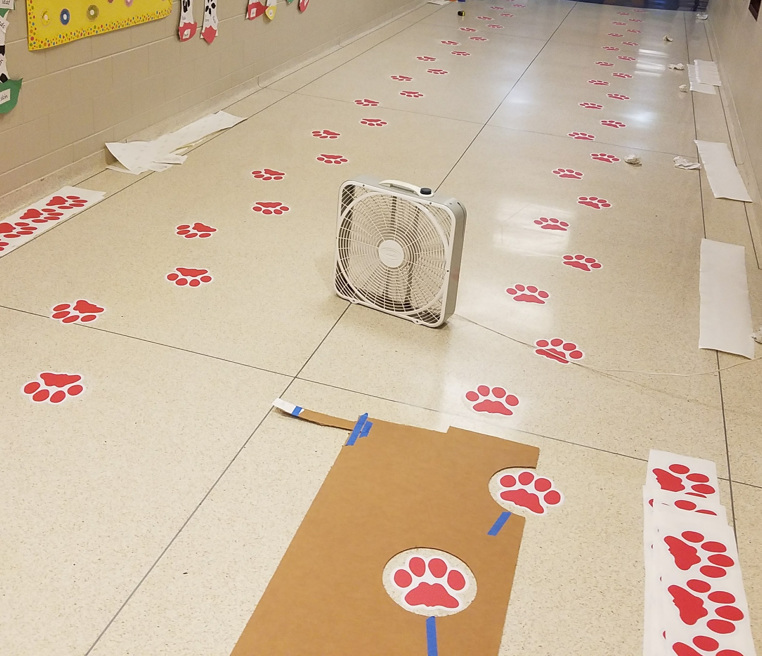

Unfortunately the school system contracts out all buildings to a third party. Wax requires regular upkeep and they don't even have a buffer on site. Here's the floor, terrazo it is -
