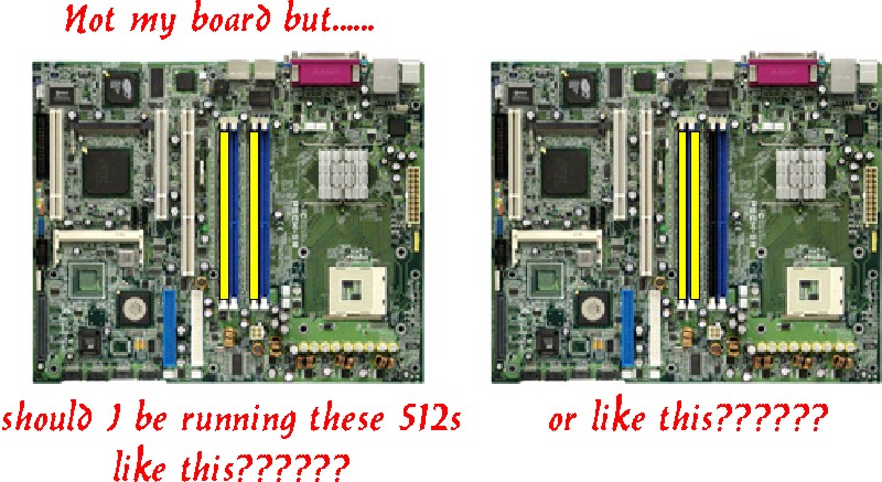

And the RAM situation .. if you have 2 sticks run them so they are in slot 0 of each pair. that gives you the best setup. To check the ram use them 1 at a time and see if the system starts up.

Run them like the pic on the left. Thats DUAL CHANNEL . better..

Dual channel like JMD above said is definitely the way to go.
