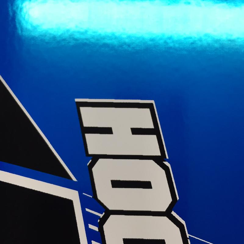

I pretty much have the problem fixed I was having before from what I can see. My next question is that all the colors seem to print good but I went to print this blue medal and for some reason it is off a lot. There is not supposed to be any white so that is how much it is off. All the other colors print just about perfect though. Is there something we need to do differently for this color or do we need to calibrate the whole thing?

That registration issue is a known problem with the Gerber Edge when the amounts on each foil is different. This is caused by the foil feed motors and if you are running Omega 4 or 5 you can fix it with RegFixer I think that is what it is called!
Thank you! We are using Flexi though so I will check into that and see what I can come up with.
