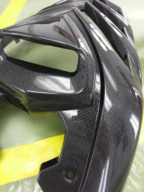

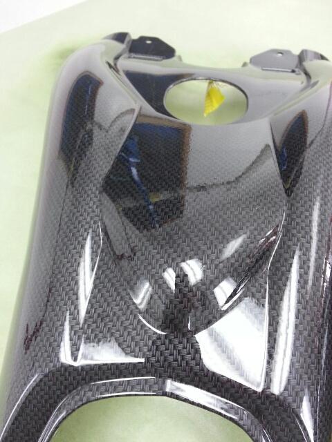

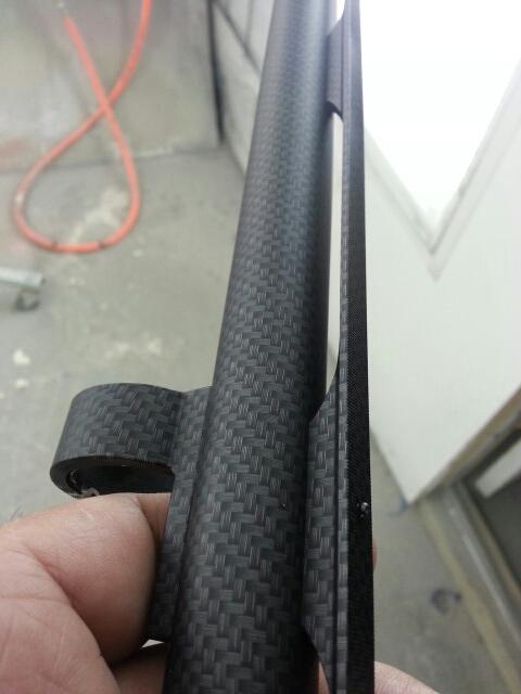

Two pics are 4-wheeler parts with gloss clear and the other is a matte finish on a gun barrel.

He does great work. I've seen other company's stuff and the extra time he takes (better prep and double dip vs. single) definitely shows. He stays covered up and has a 4 to 6 week wait. He has anywhere from 30 to 40 jobs waiting. It's crazy.

Basically what I meant by double dipping is that he will do one side and flip it around and do the other. Most of the dippers I've seen do it all in one continuous motion, distorting the print.
