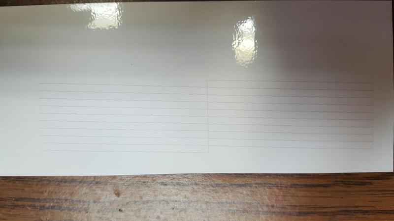

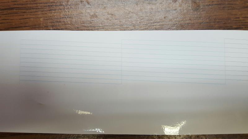

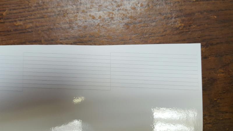

I want to see a nozzle test print.
Here you go. I didnt take a image of the yellow as i have no issues with it and that it really cannot be seen in an image. I tried scanning but it was even worse.

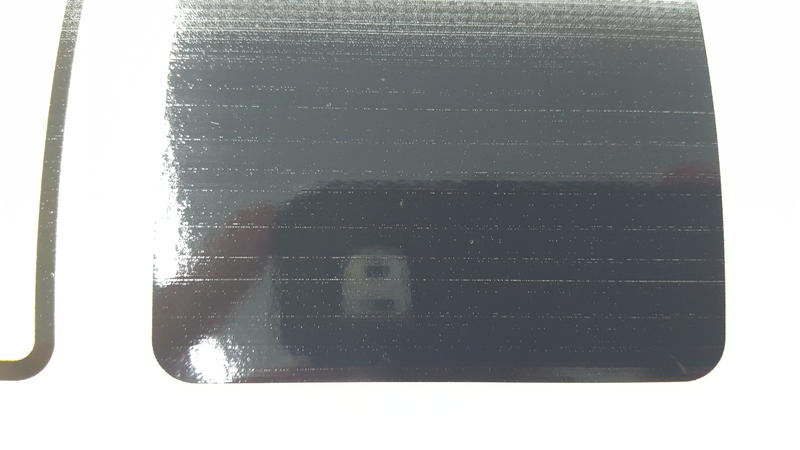

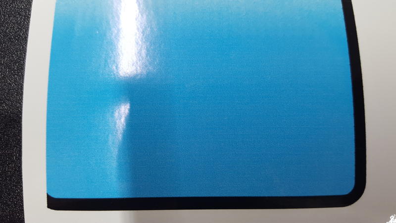

Ok back now from printing a few more samples. The best print i can get is from using the file that Castek Resources sent me and turning the Pure hue on along with opening the file directly in Production Manager for Flexi. The black is really thick yet the Magenta and the Yellow print great. The cyan on the other hand has a lot of grain in it. I will attach an image of the Cyan and the Black.
I also tried printing with the head in the high mode but it made no difference at all in the print and if anything made the black look worse.

I notice quite a few deflected nozzles in the K nozzle test especially. This will definitely play a role in what you are seeing. Have you tried any head soaks?
If you could, post a picture of the utility mode nozzle test, as that will show more specifically what the issues with the print head may be.
This head received a 72 hour head soak before it was put back together. Forward and rear flushing of cleaner.
