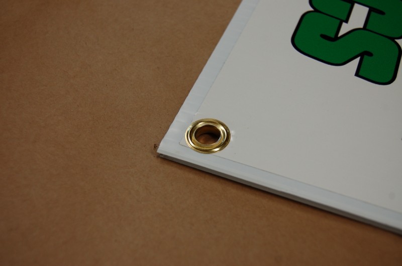

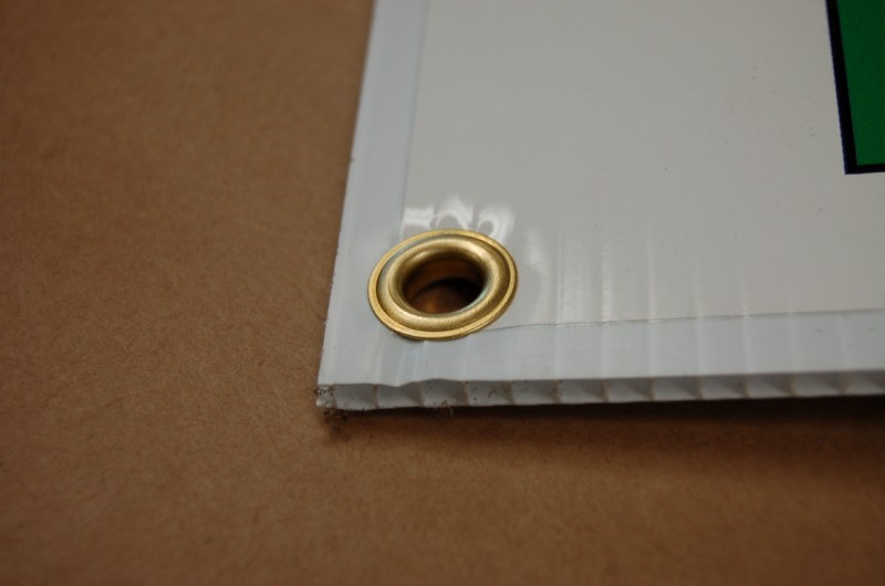

Longnecks are too long for coro. Use less pressure.

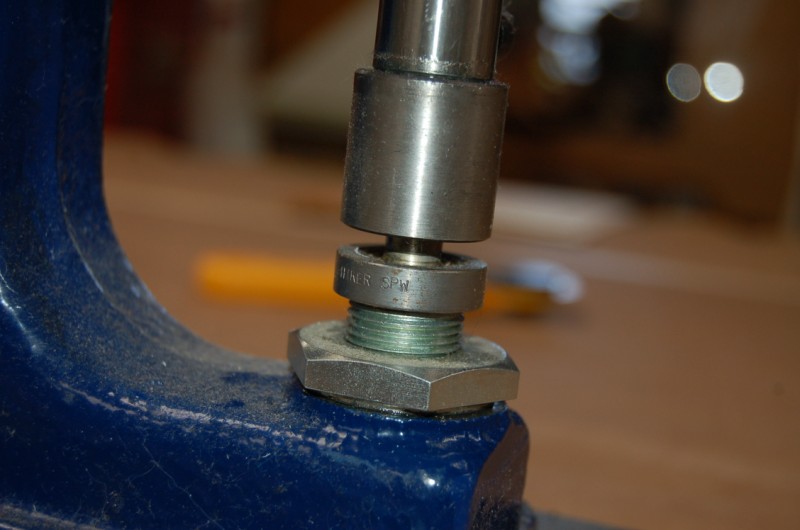

You need a spacer to stop the crush. something like a short metal rod 4mm long, placed on the centre of the press when you put the lower ring on. That will stop the last 4mm of travel that crushes. I find there is enough grip to hold, especially when doing real estate riders.
