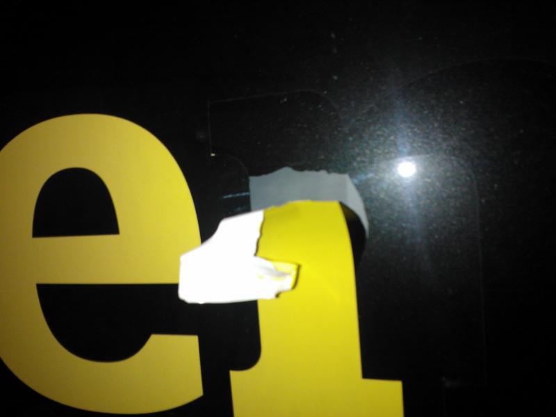

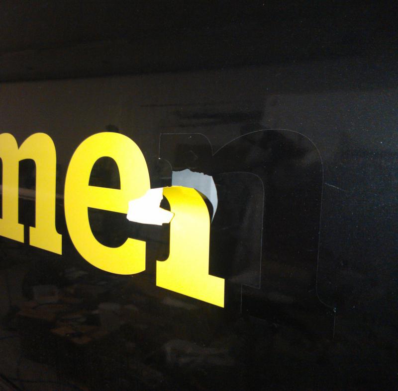

Didn't seen this either until tonight (full moon and all =)... brought in a customer's van that had some yellow lettering on it that I need to remove. The van is a couple years old, the lettering was put on a couple months ago.
When I started to pull off the lettering the first half of the letter "n" went off fine until *riip* and I held half a letter with a large flake of black, metallic paint stuck on it in my hand. Did use just a bit of heat gun (adjustable, put it down in temp), on a fair distance, just so you get your fingers warmed up or so to soften the vinyl, but absolutely not hot by any means, post-heating is far far hotter. Have removed A LOT of vinyl before and never seen anything like this.
It ripped the paint off to the base coating.
The lettering was cut by another shop in town and has white backing(?) for some reason, and I applied it this summer without anything out of the ordinary.
What should I tell the customer tomorrow? I sent him an e-mail with the pic and asked him to stop by tomorrow so he could see it for himself since I don't want to risk anything more flaking off. It looks like a crappy paint job, but I doubt the car is re-painted. It's a Nissan Primastar btw...
I don't think it could be my fault since I didn't pull hard at all, just used my fingers (no tools or cleaners!), pulled at an angle, didn't heat it up or anything, but to convince the customer about this...
