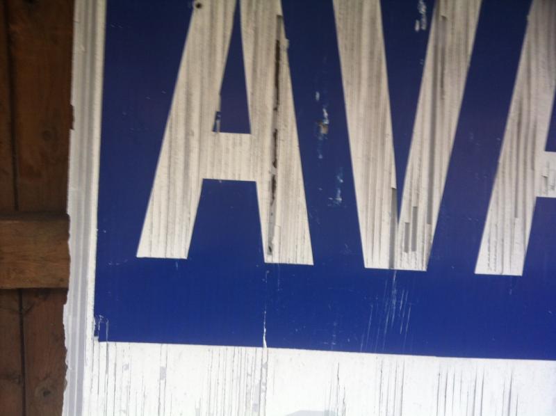

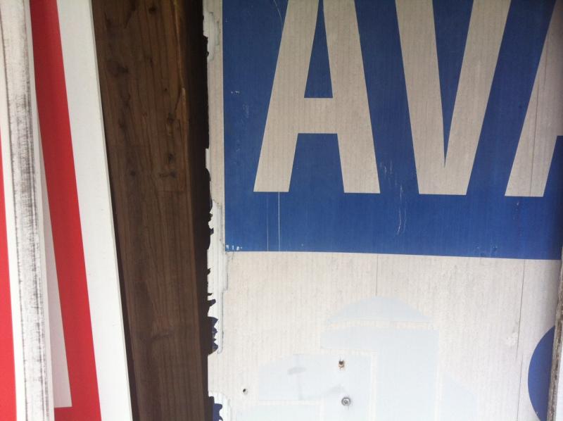

Some of our customers purchase their own commercial real estate signs and have us install them.
This one insists on using corplast because it is so cheap and they buy 100 at a time.
(and we throw out most of them when the listings expire and the signs come down)
These are pictures of a couple of them after a year or so in direct sunlight.
4mm white material with a plywood backing. 8mm or 10mm lasts a bit longer but in the end the same thing happens.
