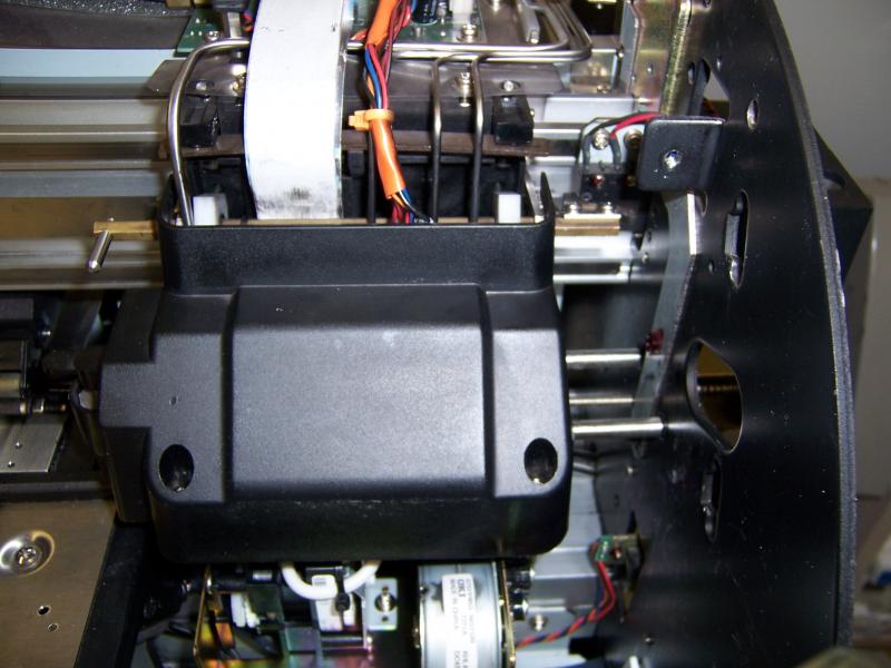

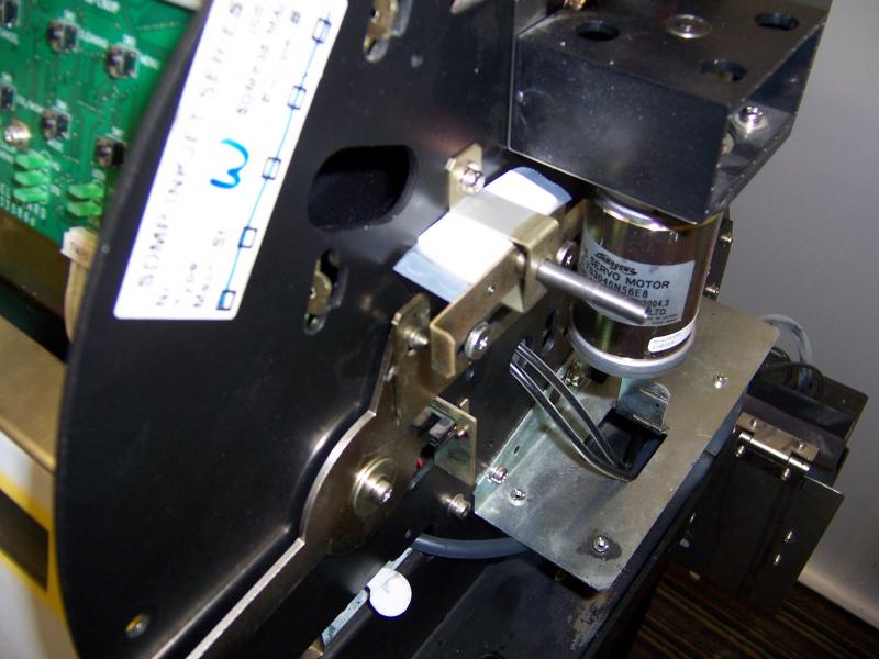

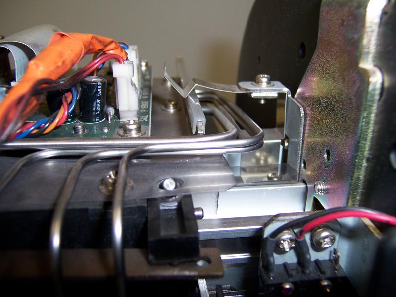

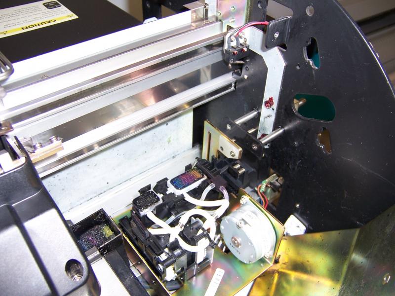

Here are some pictures, and thanks for taking the time to look. BTW, I tested the slipping issue by clamping the shaft end which protrudes from the bottom of the motor, and attempting to turn the pulley.
Picture 1 shows how i have shimmed out the media lever lockout mechanism so that the carriage doesnt run into it when returning home.
Picture 2 - carriage in home position ( no shim )
Picture 3 - I think i ruled out any issue with the lock tang at the top by removing it entirely and cycling through both with and without it.
Picture 4 - the two plungers with the cross connecting piece in the fully extended position ( no shim ) (For anyone who isnt familiar , it is located directly below the red coated screw head on the housing, right side of picture) I have inspected the grommets and lubricated these plunger shafts and felt no undue resistance when moved by hand.

tbaker
I just replaced the maintenance station in a client's printer, and this same exact problem cropped up. I fought for quite a bit to get it to quit erroring out, and the only thing that stopped it, was to release some of the tension on the retaining clip that you see in your 3rd picture. ( I bent it up a bit). Once I did that, the errors disappeared.
AUTO-FX
so, the resistance was coming when it clipped into the retainer. Hmmm. I did try to optimize the position of that retainer. Maybe I will play with it some more. Thanks!
randya
I think tbaker has the right idea.
That spring (clip) tension is a bit touchy, bend it up a little.
