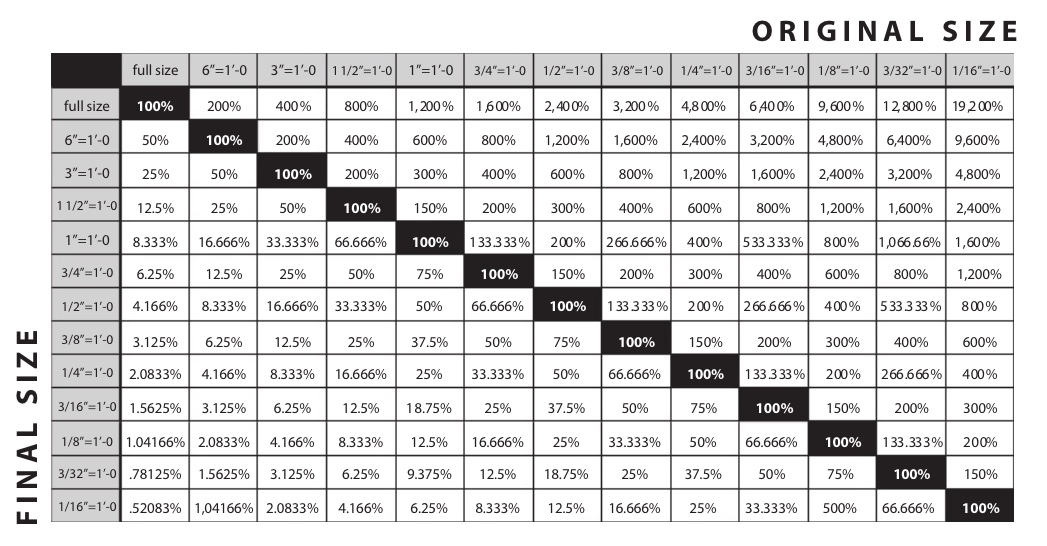

Before Cad-Tools I had this conversion information taped to the bottom of my monitor...
Another thing, How many who do not use scale are only making promotional graphics? How many are self taught? How long has everyone been doing this?
Before computers, we drew this all out, and yeah, you bet your life it was too scale otherwise would waste time and material. Back in the day, we had a very limited artboard... usually an 8 1/2" x 11' sheet... I drew on a 24" x 36" sheet, so converting to scale while using a computer was a no brainer.

Andy, I have some tips for you. Hopefully others will find these useful, too.
I had to make a template that was 2500" for a project. Working in 1:12 is not fun.
I feel like a broken record now, but try 1:10 or 1:100 scale next time. 2500in = 25in, 12" = 0.12", 96" = 0.96", and so on.
The other issue with having to work at such a small scale is raster effects.
Easy to fix. Say you're working in 1:10 scale and you want your raster effects to be 75ppi at full scale, go to Effect > Document Raster Effects Settings and set your Resolution to 750ppi.
