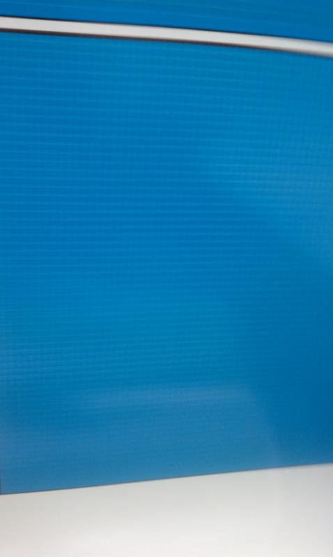

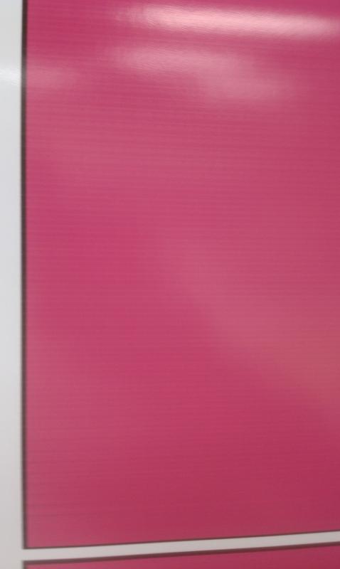

here are the pics.
SInce i didnt have mm ruler to do pf adjustment, i converted inches to mm and was on dot.

That looks like gloss scrim banner, for which ink limits and heat settings can play a large roll in getting a nice print. How does it look on matte pressure sensitive vinyl or something else that has printed well?
elitetech
i used alot of my good vinyl, testing out the print, so I am doing my test prints on banner vinyl. I was printing on 3m car wrap vinyl and it showed up even more.
HaroldDesign
Gloss vinyls can be tricky with heat settings. Try going opposite extremes with high & low heat, and see if one tends to look better. Are you using a generic profile for different medias? That will leave you having a hard time.

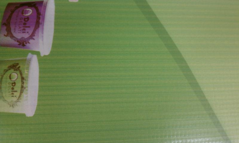

I'm sure a head collision does not help anything at all. It simply looks like there are ink limit and/or heat issues making it worse, but perhaps that is not the case at all.
Missing some nozzles may not show at all on certain images, but can look a mess printing solids. Provided other things check out and your pf adjust is good, you're going to have to get those nozzles back if it only looks good depending upon the image you're running.

Here is a pic of what i just printed. I must have the printer working for tomorrow. Gurrrr...
