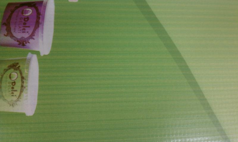

I agree on the nozzle check but I did just print about 300sqft of bright green
73,10,100,19(CMYK) on banner material......

The picture he just posted has 0% K in it... It is made up of C & Y... Without the Check Nozzle Pattern to look at, we are done here...

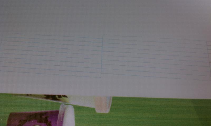

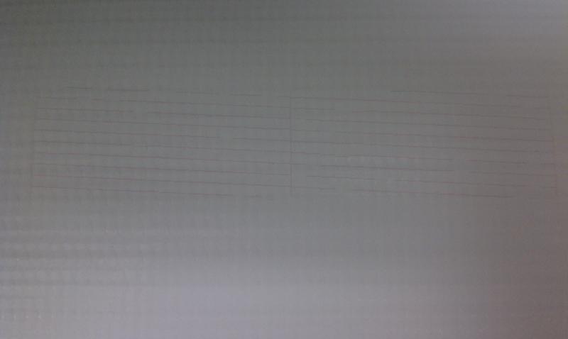

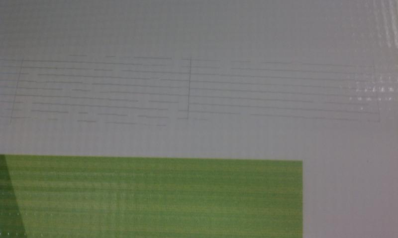

Here is the nozzel test pics, I coudnt get a good yellow pic, but the yellow is almost perfect.

You showed me the 2 channels of K, way more than 10% of it is missing... If the other colors are as bad, this is your problem......
After looking at the rest of the pics I am sure you have a really bad "Clooged Nozzle" issue... If you have replaced the Maintenance Assy as you have suggested to me then soak the Noozles and Clean... If this issue has not been happening for a long period of time you should be able to recover the nozzles, if not replace the Print Head...
Hint: Cyan is the problem, at least when trying to print a green... The K is horrible as well... How is the Magenta?

the first pic is megenta,
It is very bad as well... If you can't recover ALL nozzles by soaking/cleaning you need to replace the Print Head... Do what you want but I suggest using OEM parts and a factory trained tech, JMHO... I have been called in many times after folks have used inferior parts from eastern countries by techs who have no clue what they are doing only to do exactly what I have described here, the total cost in most all cases, the customer could have almost bought an new machine... The ball is your court now... You have indicated to me that the Maintenance Assy has been replaced, was this done correctly. Is the Head Capping securely? If you answer YES to these 2 questions and you can't recover the nozzles you must replace the Print Head... That's all the advice I have for you at this point... Good Luck...

I left the head soaked all night and now my nozzels are back to 95%. The suggestions I am getting is to get a head, and I dont think that is the problem, any one solved banding issue like mine. My issue is really on black and cyan, i see white vertical banding. I have been down for a while any suggestions at all please.
the fact that only two of the four colors band makes it difficult to reason a solution.
I did have a semi collision how do i know if the head is alighened?
