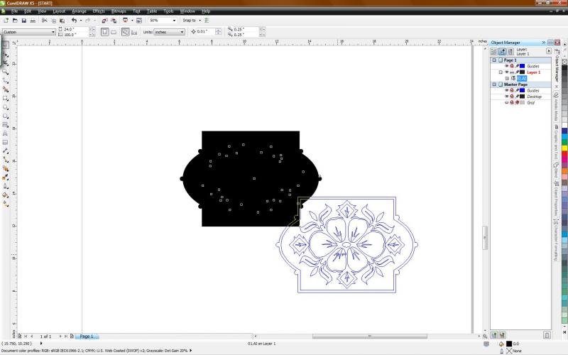

This is what shows when I import a vector image from the CD

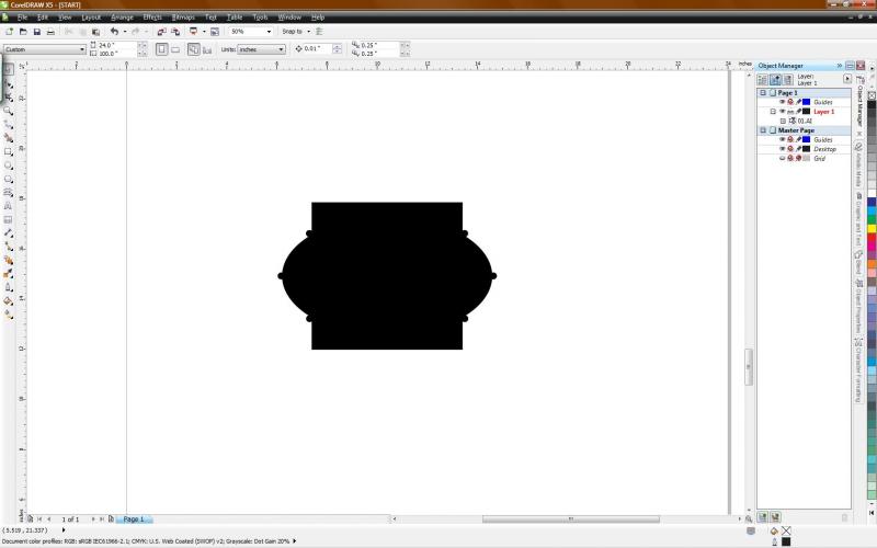

When I click the black area I can see the image but as soon as I let go it turns black again.
you need to learn how to make compound vectors and learn how order of objects affects an item.
You need a tutorial or 4. Learn the basics of corel, it will save you from asking about that issue right there.
