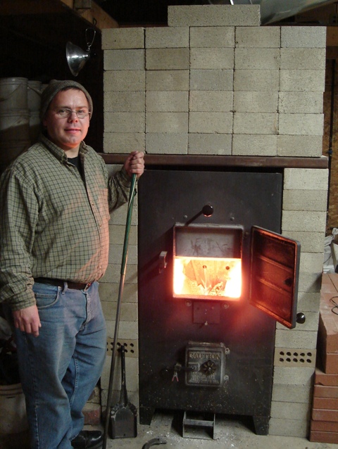

    I heat with wood and if I had my preference it would be an outdoor furnace...but our stove is indoors. Since air is a poor conductor of heat, I dry stacked about 5,000 pounds of cement blocks around it to help retain and evenly distribute the heat...kinda like a heat "savings account" that pays out 24/7. Blocks are stacked on brick ties attached to the stove keep things secure.
    The concept is based the Scandinavian masonry heater idea (a lot of mass used to retain heat). It heats my 30' x 25' two car garage (shop) and the entire 1,500 s.f. upstairs of our home (garage is beneath upper story). Even if the fire goes out (which isn't very often) it still stays warm.
    In the shop, the furnace radiates heat to all corners, and for the upstairs I let convection do the work...it uses no fans to force the air upwards or ourwards. During the last ice storm, we were without power for nearly a week and we stayed toasty warm.

    Why does it look like you are burning a dog in there ??

    What you're seeing is the cast iron grate support in the back of the stove...which, ironically, looks a little bit like my yellow lab.
    To all our PETA members, no animals were harmed in the aforementioned photo.

    absolutely lovely. I'm assuming solid cement blocks, correct?

    Yep, they're solid...we used to have a local block maker and they were only 99 cents each. It was a pretty cheap fix for all the money they've saved over the years.

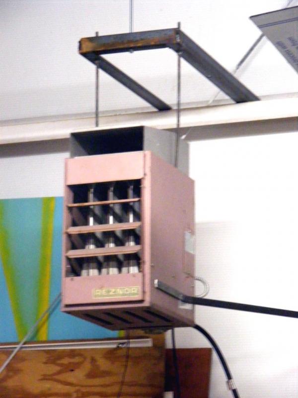

    COREL 011.jpg NORTH FLORIDA: dont get really cold here but in the 20's sometimes. i picked this up on craigslist and changed it over from natural gas to propane. i got 2 30 pound tanks....and dont use both of em between nov-march. 800 sq ft 16 ft tall shop. i have a ceiling fan in the center and run it on low when i run the heater.

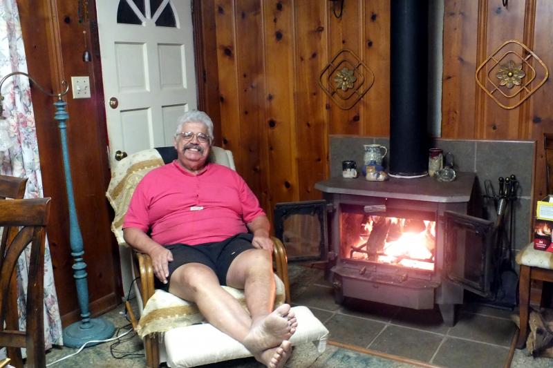

    in the house we got this....nothing heats better then a wood stove)))

    Yuck. Expensive for us - gas/electric run between 1000 to 1500 a month. For the main part of the shop two 3 ton and one 6 ton package heat/ac units. All 3 are natural gas heat. Did just add two 7 foot ceiling fans in the main front area to stratify the air and bring the heat back down. In the main install bay area - three 120,000 btu ceiling hung gas heaters like what old paint showed but considerably larger with big fans on the backs of them, plus a single 10 ton ac for cooling in the summer. Gas bills run high in the winter..... We have a chunky 4" gas main coming into the shop. Stout power too- place used to be a millwork. Have 3 phase 600amp 480v electric service too, have a huge main shutoff, my wife does not weigh enough to pull the handle lol. :Big Laugh At home, package heat/ac plus a wood burning fireplace and a second gas fireplace, also natural gas.
