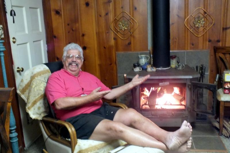

james.....the guy kept saying it burns HOTTER then a regular fireplace/stove. keeping that in mind it will not allow collection of creosote(only get this if you burn PINE) or fly ash. hotter burning =less residue know as ashes.... as for the heating of masonry....look at the pic of my wood stove, ceramic material behind it and below it...heats up allows more heat to stay in room..its been a long known fact...that this material hold and stores heat. long before bricks, most fire places were made of stone. high heat, the stones get hot, hold heat and release it slowly. i do pottery, with kilns. to reach bisque temp 1700 degrees............takes a good 8 hours. THEN IT TAKES THAT and 4-5 hours more to come back to room temp. when doing a glaze firing double the time as now your heating to 2200 degrees. when my shop is cold i plug in a KILN put the ceiling fan on low)))))

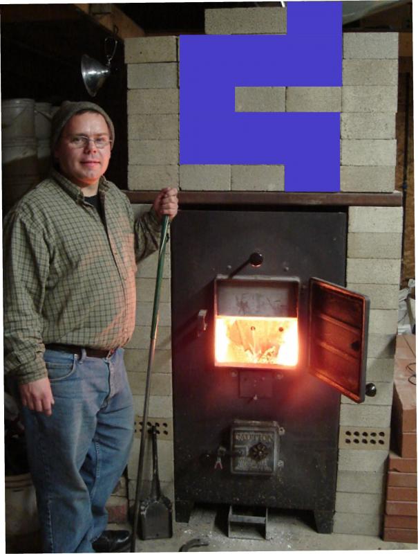

He mentions the differences between “black oven” and “white oven” masonry heaters. The former routes the flue gasses through the monolith of masonry, whereas the latter is indirectly warmed by the flue gasses and radiant heat.
My setup would be considered a white oven. The attached photo shows the (blue) interior 8” x 8” path of the rising heat. Since this photo was taken, I’ve added another three course of block so the heat takes one more turn before exiting into the shop. A 12” diameter duct next to the opening at the very top allows the rising heat to feed into the main trunk of the upstairs heat runs.
