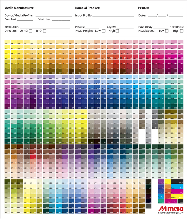

To the OP, we have a digital printer in shop. I have printed out a large PMS color chart and laminated it. The colors do not always match up perfectly with the color swatch book but rarely does that matter with our clients, (local sign buyers). What it does do is give me the ability to allow them (or me) to pick out a color from the chart and know that that color will look exactly like the swatch that was picked. Perhaps your MM could provide you with something similar for a reasonable fee.
Did you create this chart from scratch?
No, it's a file we got from Mimaki.
Attached is a .jpg representation of it. Original fiile is an .eps.
Trying to attach a .PDF of it to this post keeps failing. It's 3.7MB. Not sure what I'm doing wrong. Even keeping within the 800x800 size restrictions it fails.
I'm sure it'll fly over email if you want it.
