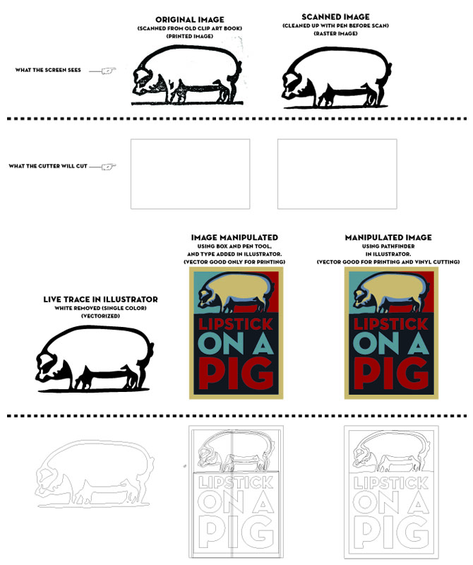

That was fairly coherent for OlPaint.. me thinks he is not on a chlorophyl rush or has the wheatgrass jitters....
Anyways, I did this quickie thing a while back for a newbie... I modified it a little bit for this, maybe this will make sense to you.... oh and I did have lipstick on that pig, but took them off. If I kept them on I could never have a bacon again....
