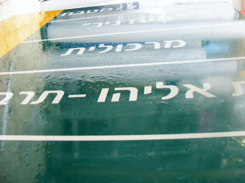

    i have a problem hear
    i applyeid reflective 5 years china made on polycarbonate
    100\250 cm
    wet white shoap
    a lot of bubbeles turn on the nexst day
    u can see a pic heare
    (wornning not 4 a weak hart :)
    i nearly up my mind to make it all new
    the bubbels r empty only air no wather inside
    (im sorry that its my first post, beutifull pics will come nexst
    thanks 4 all hgelpers:help
    ronen

    I'm not sure I'm totally with you, but did you pull the protective film off the polycarb the same time you installed it? Some people say you should pull it off and allow it to sit so it can outgas. What you described sounds like the polycarb outgassing.

    You can't apply reflective wet either. I think that's where your problems started. Even if the bubbles aren't holding water, I would bet the wet application is why you are bubbling now.

    you're definately in trouble. sorry to say. best bet is to poke with a knife and use a lot of heat to help make the best of it...
    the bubles might not be filled with water, but they are filled with water vapor. reflective vinyl is metallic, which traps water between the layers. you think you squeegee it all out, but its still there... just waiting for the chance to vaporize and create the bubbles you see.
    highly recommended, if not absolutely necessary, to NOT apply reflective with water. If your supplier doesn't have an air-egress version of reflective, at least laminate another vinyl, that allows for wet application, with reflective before cutting/applying.

    I believe you're going to have to start over as you already stated. That looks as if you'd have 100's of holes and squeezing of air/moisture out that will really weigh heavy on the integrity of your installation, not to mention the vinyl is not meant to have 100's of holes in it from the start. A few here or there is acceptable, but not as many as you'll need. Also, even popping all of them, you'll never relieve all of them and it will still look bad, so I wouldn't waste my time.

    The only reason for the not wet advice is that there have been some cases of mildew or corrosion resulting with the reflective film after some significant time has passed. The problem shown in the picture is, IMHO, not the result of a wet application but is outgassing of the polycarbonate.
    The solution is to strip off the print, allow the polycarbonate to outgas and then apply a new print. You should also check that you are using the designated side of the polycarbonate for the application. One side is treated and one side is not on most polycarbonate sheets available these days.

    This was an improper technique install. Those mini bubbles show that.

    This out-gassing theory still baffles me. I've never noticed the protective liner to have any bubbles under it. Presumably the protective liner was installed long before any "out-gassing" would have finished taking place. Why is the liner immune to out-gassing?
    I think this poster simply applied the vinyl poorly and is hopeing someone can tell him how to save this job.

    about the gassing thing, i herd about it and talk white the manufactor befor
    i installed
    he said the the amout of gas that the stuff reales can never be as huge as a bubbel.
    and yes i pull the protective film off the polycarb
    its not my firs time applaing reflectiv wet white shop, no problems until naw
    in the chip crapy reflective vynil, if u will leave the shop 4 long it will make spots in the reflective angel.
    my gess is that i didnt soak out all the water (i acutually bougth a new wiper, like a long kitchen wiper.. for this job)
    u can be shur that we didnt see any bubbel when we finshed, everything looked smooth and safe
    i had to use the short plastick wiper...
    any info about wipers 4 wet applay will help (my big sqigee is on its way)
    when i think about it , i layed the polycrap, and not landscape it on the wall,( this way the water falls down and not stays)
    eider way im going to put the sign for a bit of sun ten somtimes it helps
    but 99% a redo on this one
