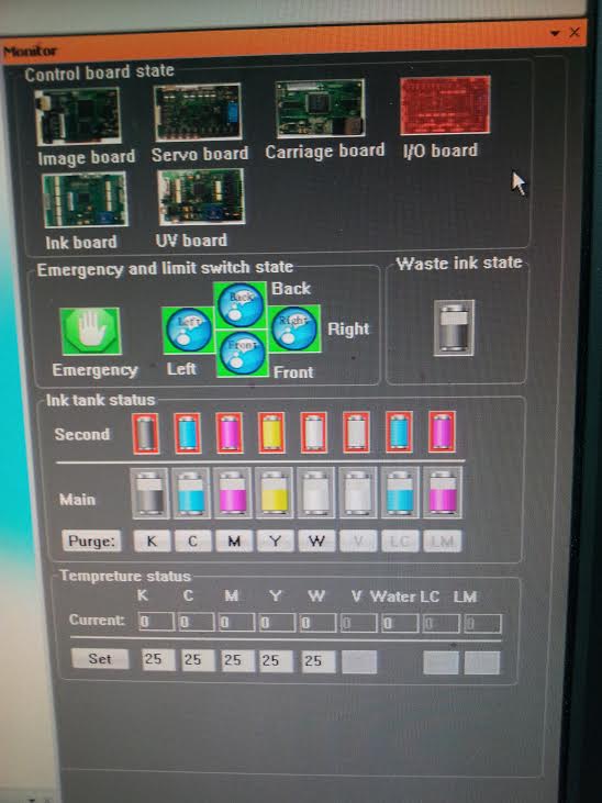

    need help for UV Teckwin Teckstorm XL
    Hello to everyone!
    I'm writing you from Bulgaria, we bought a second hand printer UV Teckwin Teckstorm XL, it was working when we get it, now we install it and we have problem with the I/O board (is in red on the software) the pomps of the inks don't work all and the second ink tanks are empty, we changed the I/O Board but there is no change if someone have any idea why we have this problems please help us. unnamed.jpg

    Germany/NRW
    check the powerline to the IO-Board become 24V/36V (is present)

    Hi! Thank you vary much for your answer, we have installed the printer and now we print, I want to ask you does anyone know how to change the print head voltage, because we have this problem with the red and the white they start ok and after 10sm- 20 sm we have some bad nozzles, and when we start the printer at the beginning we don't have such problem when the ink is not so well worm. At the nozzle test, the head is in perfect condition.
