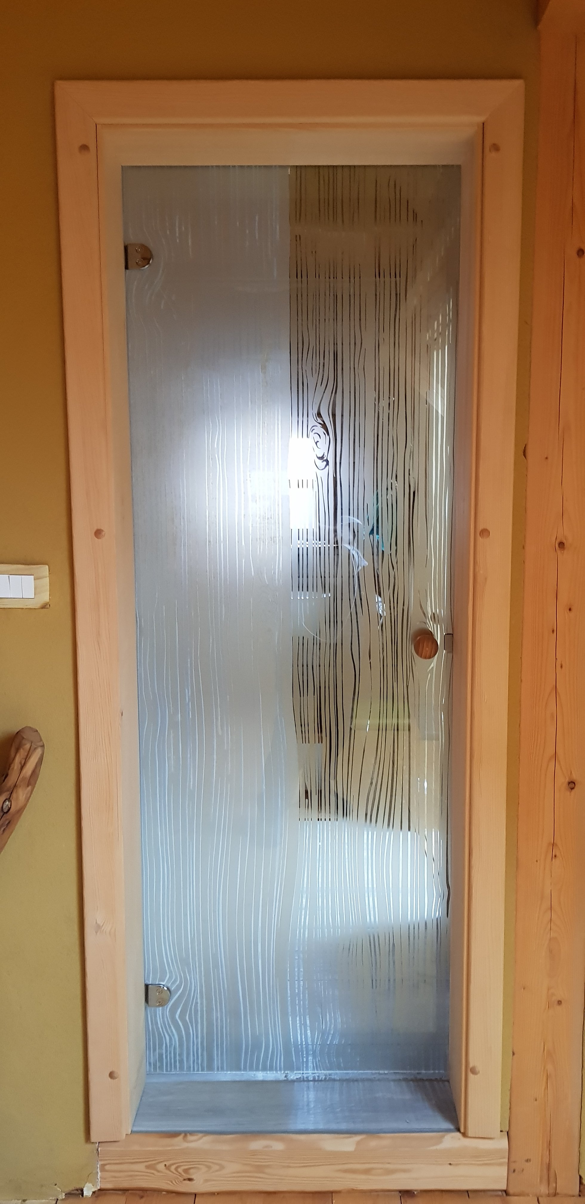

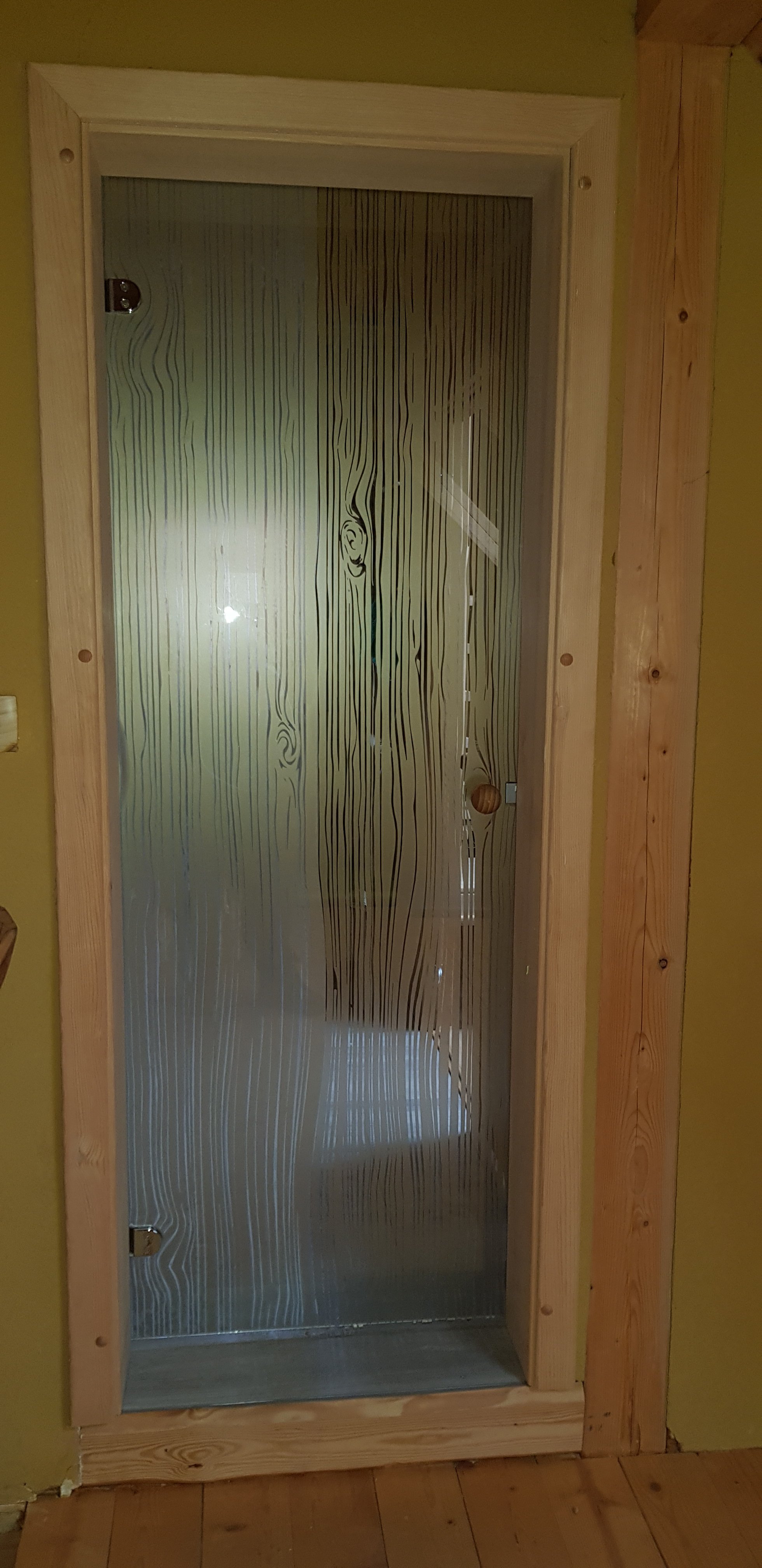

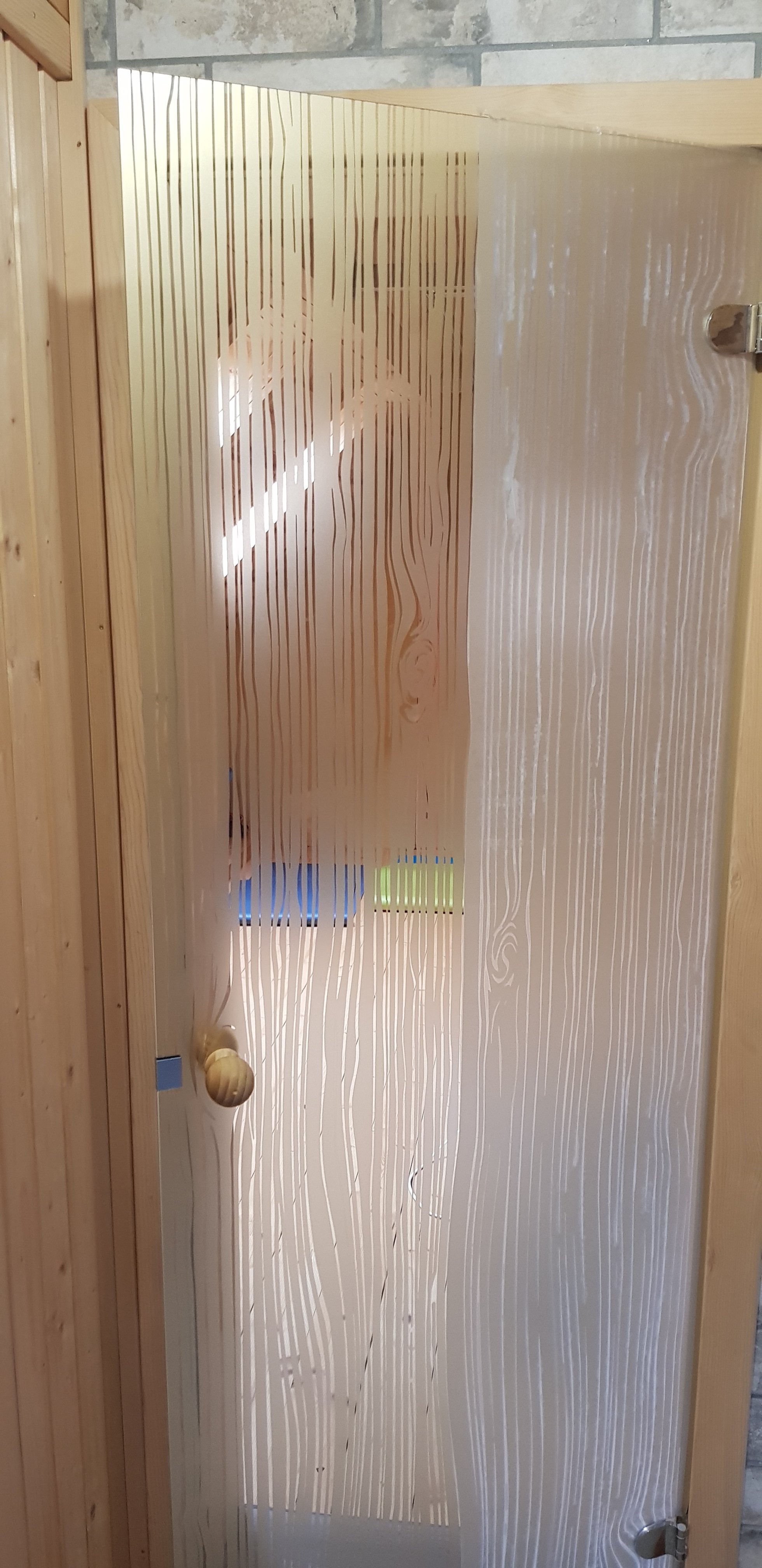

    hello guys.
    im have installed few square meters of this frosted vinyl (we call it sanded vinyl). but everytime im having problems with istalling it, if it has some complex design, like some thin lines or something like.
    i usually overlay it with paper transfer, because im doing wet installation. what do you use for transfer? paper or ovc?
    do you always install it wet? i do, because if i do it dry, a usually get this very small bubbles, which defently disappere in time, but right after job it doesnt look nice, i can tell from customer face. :)
    if you do wet intallation. how long do you wait before removing transfer? or do you leave it, and came back next day? or do you finish it in one day, and dry it with heat blower?
    just today i did this complex design, and i almost lost my nerves. i was warming glass door with standing fan heater, so it would dry faster. but instead of drying i got wrinkles all over surface. so i have to straighten these wrinkles and then i proceed with removing transfer. ofcourse everyting was streching... i was i a lot of troubles...
    it makes me so nervous that i leave it till tommorow. i will probably remove instaled decals in reinstall it dry. but im affraid that i will get this small bubbles, that i was speaking earlyer...
    im using orafol, gold frosted. for installing i use water and soap.

    We've gotten away from homemade application solutions. There are just too many unknown additives in dishwashing soap and depending on the quality of your local water, it can produce cloudiness on clear decals and other undesirable effects.
    The folks who manufacture RapidTac have a formula specifically for window graphics. It sets up faster than their standard product and also allows you to use far less. Technique is nearly everything with vinyl application. Patience is also critical.
    With long vertical graining like you've shown, make sure you're going WITH the vertical graining and less side to side motion. You should be able to look at the back side of the glass and see bubbles if you have any. Some bubbles are in between the vinyl and the transfer tape, so give everything a good amount of elbow grease a couple of times, go take a long break and then decide if you think its ready to peel off the transfer tape.

    yeah... orafol doesnt offer rapid air frosted vinyl... that would be the best solution.
    i know that if i spray paper transfer it would come off easly as dry... but whenever i did it like this the decals were still peeling off... im talking about wet installation...
    tim: how to do such long vertical moves? on the whole height? thats are some long moves... but will give it a try...

    How do we do it? Practice my friend. Practice.
    If I was doing this door all by myself, I would place a tape hinge across the width of the masked off graphic about a quarter of the way down from the top. I'd then peel back just that much of the decal, slice off the backing, VERY lightly spritz the back of the decal while trying to stay at least 4-6 from the remaining liner so it doesn't get too wet. Using a Teflon squeegee, I'd start squeegeeing upward several inches above the remaining liner in the same vertical direction starting in the center of the graphic working my way upward and outward without too much side to side.
    Working quickly to set that section and move on before the really HARD squeegeeing gets done.
    When that section is in place, I'd pull outward on my decal and peel off the tape hinge and more of the liner, then lightly spray my RapidTac II or window formula and start working my way down the panel.
    Once the entire graphic is in place, I'd start pulling long vertical strokes with the Teflon squeegee stopping every so often and checking the back side of the glass for bubbles until I comfortable with it.
    After a long break or even a hour or more, I'd squirt the transfer tape with plain water, let it soak in and then gently peel it off at a 180 angle if that makes sense. If you peel the tape off at an outward angle away from the glass and anything hasn't set yet, you'll lift the graphic.
